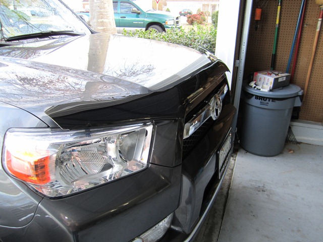

Toyota. Front looks great, from the side you have to get use to it hanging out a little. secures well to the hood, no whistle.

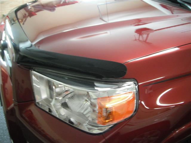

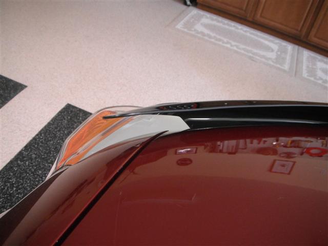

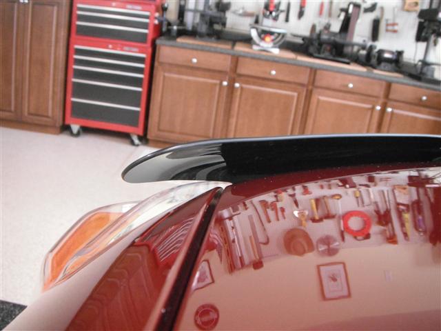

Based on a comparison of bug shields, I think I know where the whistle is coming from for those who are experiencing it. The AVS shield wraps around the front ends above the headlamps a bit more then the OEM shield. However, in that area, it is flat piece of plastic turned at an angle, with no curved plastic support underneath it as found in the front under the hood area. At speed, I bet that flat piece of plastic is acting like a reed instrument or the angle of the outlet of a whistle, you know, the part that makes the sound when air blows over it.....just a guess.
