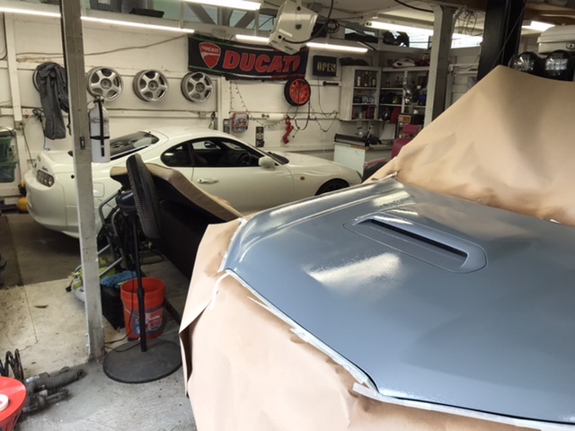

Working on attacking.... most likely will go with plasti dip on the hood first to protect pain and have a uniform look then 3m spray adhesive and/or double stick tape.

Hoping to have the panels on this wknd. Prepping the hood.
