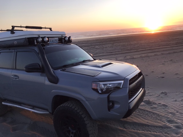

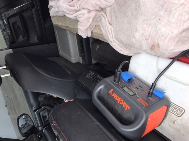

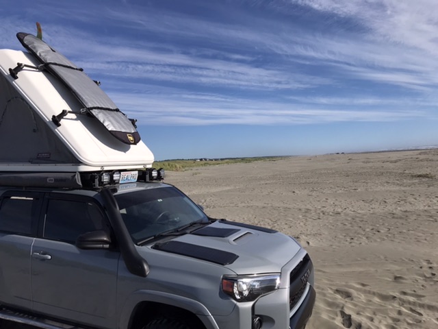

That sucks. Hope you get it taken care of. I have been running my Jackery as pass through for two days on the beach to power my fridge. Beer still cold as I type this from my rtt.

0.7 mm VHB, no vinyl, straight on the paint. The tape is run along the entire outside edge of the panels to hold them completely flat against the hood. I also added two strips in the middle to hold it away from the paint a bit and prevent rubbing in the center (sorry no install pics). It is entirely more than I need to hold them in place (VHB is insanely strong stuff) but it's best to run it entirely around so there's no gaps. I've worked quite a bit with VHB so I'm not afraid of the removal process if I do ever need to pull them off, already did it once with these as I wasn't entirely happy with my first shot at placement. VHB removal is not what I would describe as a good time but as long as you're patient and let the adhesive remover do it's thing it's pretty straightforward. If I was planning on selling ever I might have wrapped it first but idc, this thing was pretty pinstriped already, not that it really shows in the pic.
