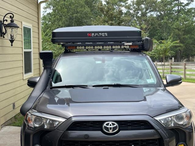

Easy install, used the recommendations of VHB tape. Put four strips down the center, considering water egress and not worry about the edges peeling up. However, I did lay down vinyl, first, will see how it holds since it's not in direct contact with the hood.
This was the best option for me as I park outside and only commute 20miles round trip to work, so the extra trickle helps. I opted out of the controller as my redarc has a solar hookup.
