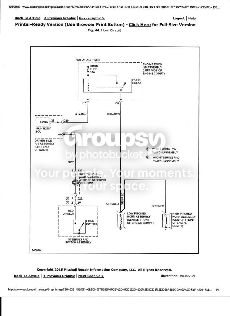

The next time the horn remains engaged after being released... try pulling the 'Horn Rly' from the base located in the main fuse/relay box under the hood (should shut off right away); "See schematic diagram":
I have a feeling that the original horn relay carriage is hanging up when in the Closed position. To avoid taking the truck back to the dealership and leaving it with them, you can likely get this relay at autozone for $12 bucks; just take the old one with you to be sure that they match it up properly! Best!

Hi Doc,
Yes... the very same relay that reacts to the horn button on the steering wheel when pressed, also responds to the signal from the 'Main Body ECU' when summoning the security system (horn) alarm; "See the diagram below":
Notice at the bottom of the diagram, the 'Horn switch' (above ^^^^) on the steering pad assembly. Now see the Blue Trace that goes all the way up to the Horn relay? Notice that the same line is shared by the Main Body ECU right where the Blue and the Pink dotted traces come together. **I seriously doubt that a short circuit has anything to do with this trouble. And because short circuiting issues are 'usually', intermittent and/or unpredictable by nature, this glitch doesn't really fit the profile; this system is behaving exactly like a Typical, temperamental, sticking relay or similar Hardware issue ...even the horn switch (in steering wheel) can stick.

Hi Doc,
