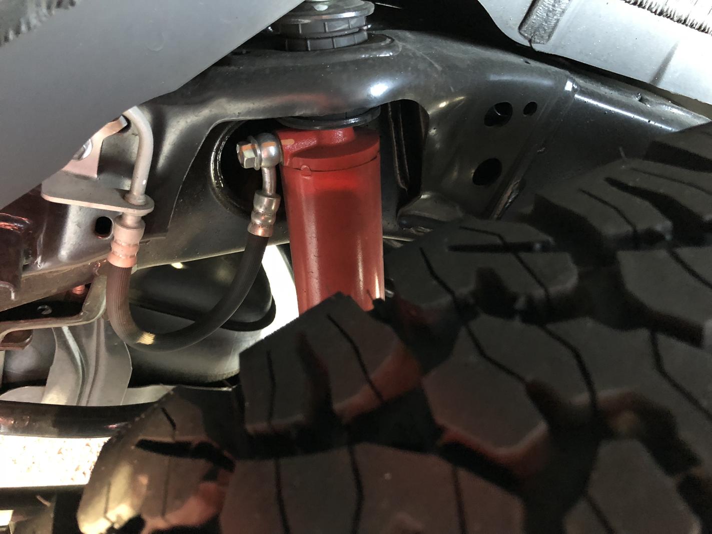

If its an Sr5, it doesnt, if its a sport, it does, if its a limited, more than likely it does.
You can look at the shocks and see if there is a hydrolic line going to it.
XREAS or not?
Just purchased a 2018 4Runner Limited and love it! Just want to know if it’s equipped with XREAS or not. Hope the pic is clear!
I plan on installing leveling kit and would like to know before hand.
Yes it does. You can see the hydraulic line coming off the shock, no other OEM suspension setup has an open shock like that.
