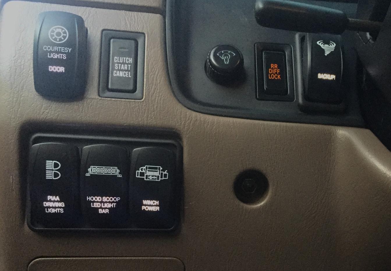

Using this type of switch, should hooking up wire #3 to the green and #4 to white/green yield the desired effect of having the switch LED dim along with the factory switches/dash lights? Thanks
If by Wire # 3 you mean the one labeled Red 2, then yes you are correct.
Correct, as in, if it is going to work, that is how you do it. Dimming LED's is not always going to work, so if the switch is not designed to dim, it may not work well. I don't see anything on the wiring diagram that says the thing is meant to dim.
FWIW all of the switches with LEDs I have installed from OTRATTW dim just fine and are wired to the dimmer switch as previously discussed.
