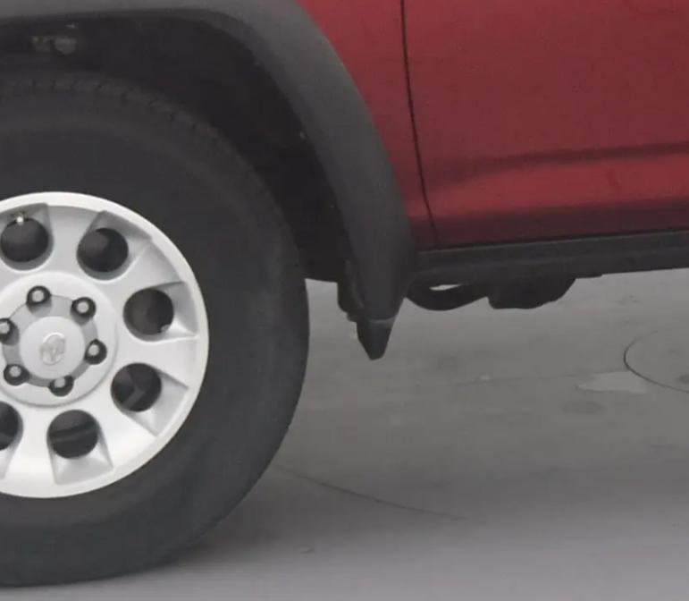

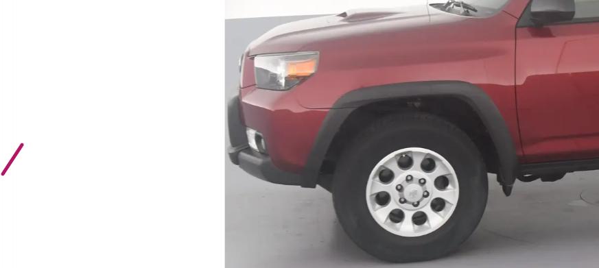

Any chance this is the KDSS thing under the driver side on this?
I can't get any better photos of this one on Carvana, curious is this has KDSS or not

Maybe the listing degraded the 360 view where you can't see the skid plate cut out and I'm wrong
I don't see the rear sway bar link in front of the rear wheels either. Rear sway bar link is visible in the wheel well on Non KDSS vehicles.

It has a hydraulic ram connected to the passenger side of the sway bars and a fixed link on the driver side. Bend down if you can and look underneath the truck. The front skid is also different with kdss. If you plan on lifting and off roading your truck I wouldn't get kdss. It's worthless and just in the way after lifting an inch or two.
Doesn't look like it has kdss. Skid plate doesn't look like it has a cut out for kdss piston travel.
The thing behind the wheel is just a brace found on all 5th gens.
I agree. using the 360° view, I can't see the cut-out in the skidplate for KDSS.

"Maybe" is the key word. It doesn't show a kdss cutout on the skid plate but it also doesn't show the non-kdss rear swaybar link in the wheel well.
It is a crapshoot.
