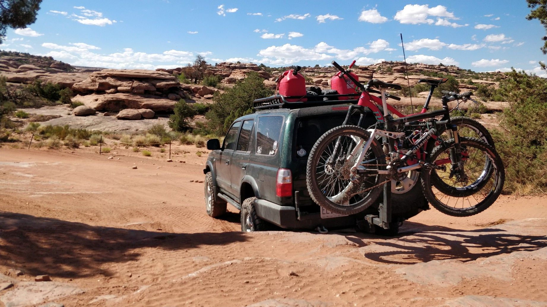

I have a rear swingout bumper (4XInnovations), and do some moderate wheeling with bikes on during our Colorado/Utah trips. The main issue is getting the bikes tucked in close to the truck and high enough to not get dragged going over ledges, and if they do get dragged, held in such a way as to not damage them.
Even though the bumper's receiver is higher than normal, it's still not really tall enough to get the bikes up out of danger, so I use a receiver drop adapter installed upside down - this also works to get the rack far enough out to clear the spare tire. Then the main issue is that you can't really get into the rear hatch without removing the rack - since the dropper reaches up and blocks the swingout. So that's a bit of a PITA when camping/overlanding - every evening, have to unload the bikes and unbolt the rack to get into the rear (there's a cargo platform - so to get to the stuff underneath the raised floor, the hatch has to open).
And the rack I'm using is just a simple type that has two arms that you're supposed to hang a bike on via the top tube. But modern bikes don't have nice straight top tubes - my Niner's is very curved and if I mount it the 'right' way - the front wheel drops *way* down, so I end up setting the downtube on top of the arm on one side. The plus side of that style rack is that if a wheel getts nudged or brushed - then the bike is just secured to the rack by rubber straps or bungee cords - and can fairly easily move and avoid damage.
On the Gold Bar trail out in Moab a week ago (+/- a coupla days):
Far from ideal, but it sort of works. I keep trying to think of a better solution, but I don't want them on the roof because sooner or later I'm going to run them into something. It would be nice to have a rack that holds the bikes by the wheels so it doesn't beat and scratch up the frame (putting a dirty mountain bike frame onto a rack - grit gets to grind away as you bounce along a trail).
I sometimes ponder putting some fork mounts on the rear end of the rack and just letting the bikes dangle down. Downsides to that are that out of the 3 mountain bikes we generally drag around, they would need different form mounts (QR, regular thru axle, boost), plus road bikes. And with the fork fastened firmly to the mount, if something reached up and bumped the rear wheel, something bad is likely to happen - no give.
I'm currently pondering a 1up just for the ease of use and lack of damage to the bikes - an improvement over the current rack. But I think it would need an even taller riser/dropper than I'm currently using because from the measurements on the 1up site, the rack would hang lower than the wheels currently do. Don't want to wreck the rack. Maybe something silly tall like this: https://www.amazon.com/Quick-Adjust-Receiver-Hitch-U-4043/dp/B071R35K26
I'd still need to remove it every evening to access the hatch area, but at least the bikes would be less beat up. My wife refuses to put her CF Niner on the current rack.

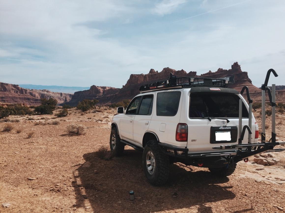

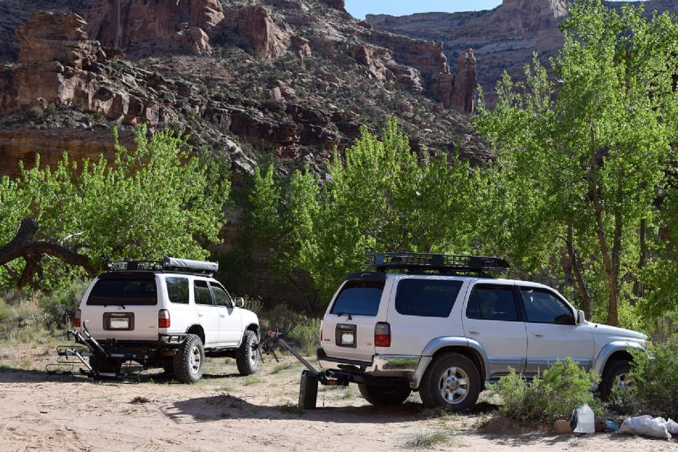

I regularly do similar trails to you and went through 4 different racks and ended up with the ISI bike rack system. They are out of Austraila, but they regularly work with US customers. At the time of purchase a few years ago, they didn't have a US vendor, but maybe they do today? I've never scraped and the departure angle is better than anything I could find. They are expensive, but very much worth it to me. I never have to worry about harming the bikes and they stay put really well. They do have extensions on the hitch so that it can work with a rear swing out. Customer service is top notch too. I don't have access to any of my photos with the bikes loaded, but this photo gives you an idea. Their website has a lot of customers photos that you can check out. /iSi Advanced 4x4 Bicycle Carriers | Extreme Duty | Offroad | Cars | 4x4 | Caravans and Camper Trailers
Picture of it folded down to access the rear, also the silver bars do come off completely with a turn of T-handle near the bottom.
Hmmm... that one looks really interesting. Certainly raises the bikes further up than the 1up does (40 degrees vs. 15). I'm not sure exactly how many inches of clearance I have to work with between the receiver and the swingout. I need to measure that. But if I could open the swingout with the rack folded down that would really fit the bill.
EDIT: After clicking around on their site I 'discovered' all the options they have on the pivot base portion of the rack: iSi Modular Bicycle Carrier - Extreme Duty Modular Bicycle Carrier Design
Between the high, std, low, ultra low, one of those would absolutely work, I'd just need to measure how much clearance I have and get one that barely clears, to leave as little as possible hanging down. Even if the bikes don't hit I somewhat routinely bang/drag the hitch.
