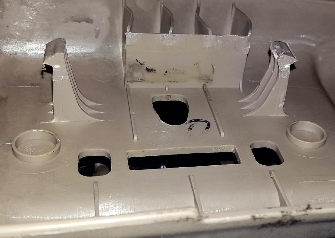

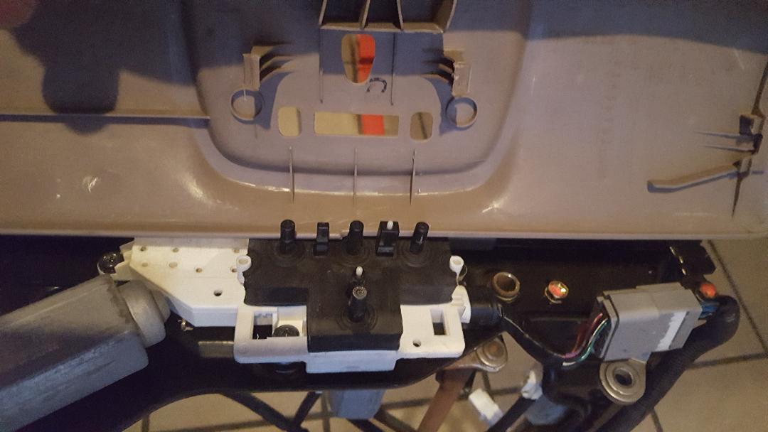

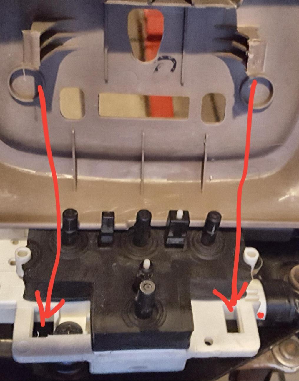

I just took mine apart and am reupholstering the seats..... so you get pix !

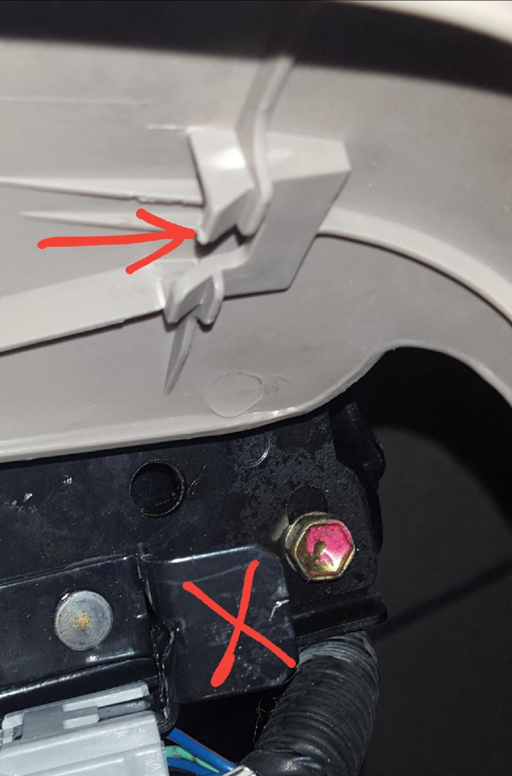

Slide the front on 1st( the arrow around the X), then the 2 tan clips push into the white piece around the switches, then the screw in the back.

I have a 98 base model with no power seat, but yeah there is a hook/pocket thing that fits onto the seat track towards the front of the plastic cover and the on the track on the side towards the front, and then screws toward to the side/back to secure it.
Slobo and Wedgie you guys rule! I thought the lastic shield held the power switch module, now I see that the module is screwed to something on the seat and the shield is hled by the power module!

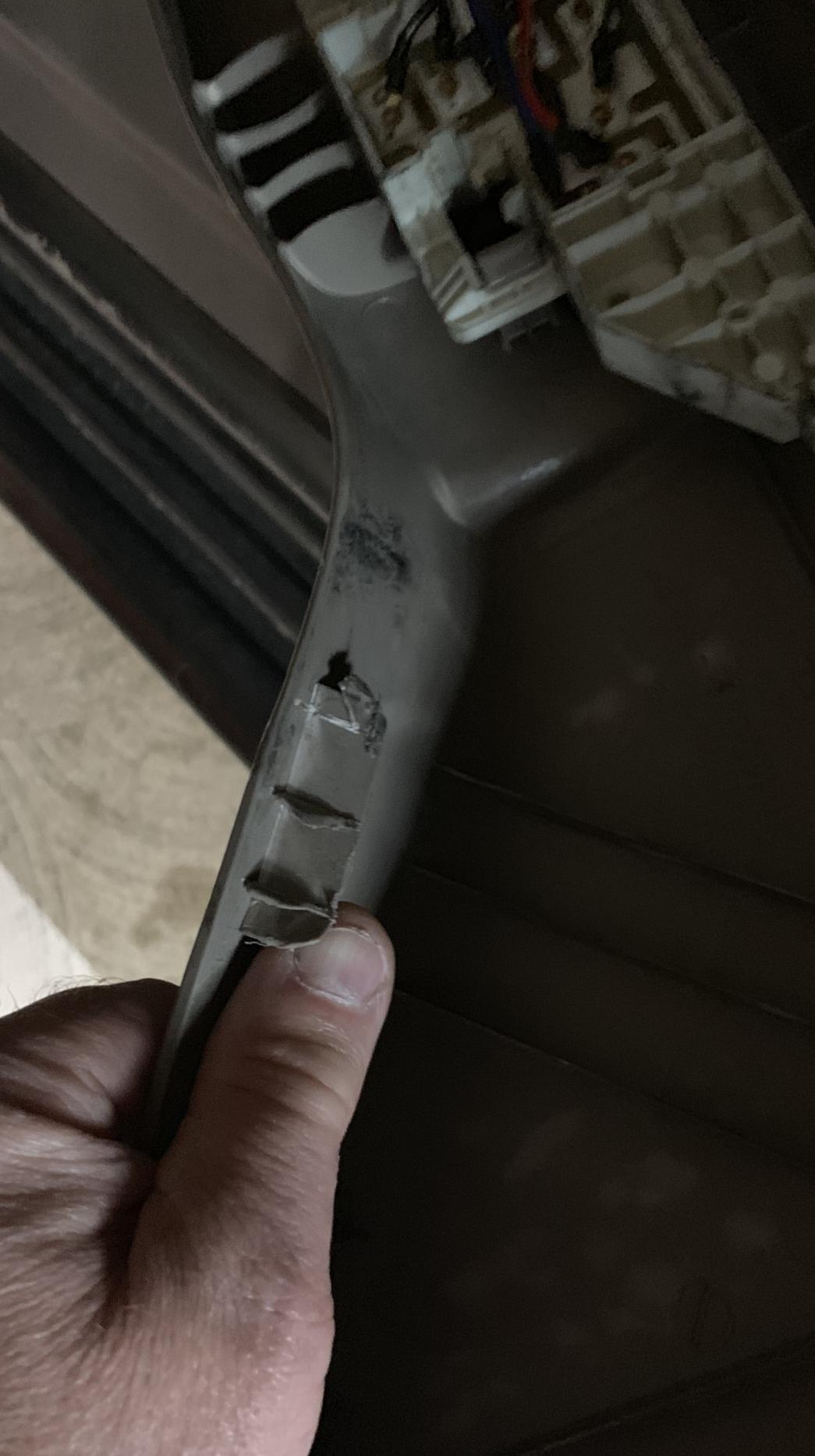

Still not sure what the tab at the top mear the back fits on, mine is bent and floppy, will post a photo later when I get home.
Dim photo but the tab where my thumb is, where does it go?
I've removed a number of these panels, and I think no matter how careful you are, one of the two tabs almost always breaks off. Fortunately one tab (plus the screw in the back) is usually enough to keep the piece in place.
