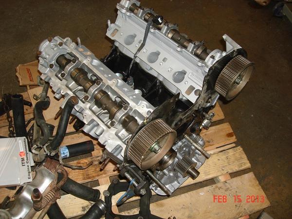

I just had a whole new 3VZe installed... hopefully it will last a long time.

I have about $4500 in the new engine install. The engine was close to $2000 and the labor and parts and supplies and oil and injector seals and tranny cable and... well, you get the idea. It can snowball downhill real fast.
I now have a "like new" 1995 4Runner that I could never sell for close to what I have in it... and that's ok with me. :)
