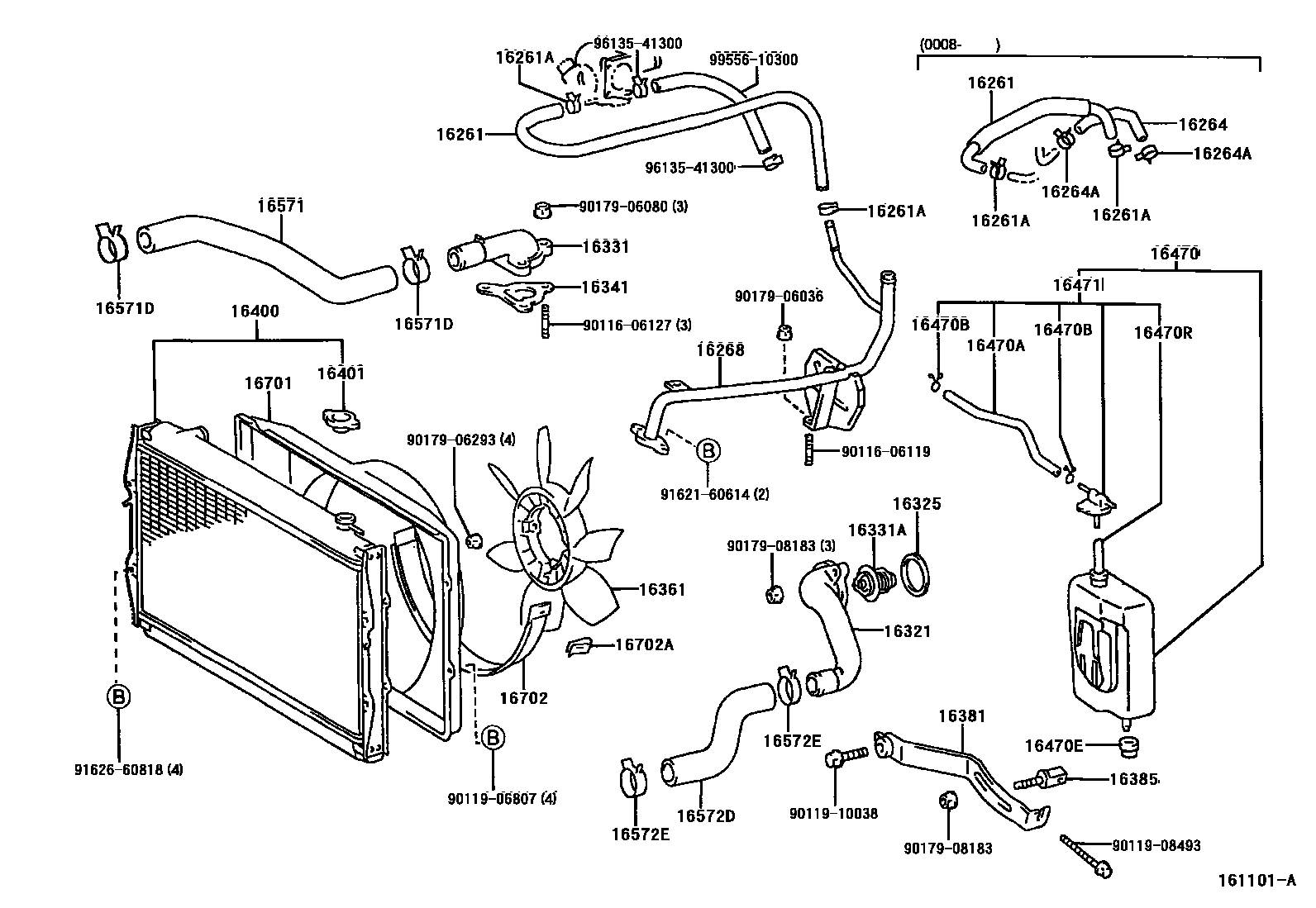

Obviously the radiator hoses and there seems to be some sort of coolant lines going into the intake manifold. Does anyone have a list of the hoses. I don't want to find out I missed one or two
4, unless you have a rear heater, then 5.
Upper and lower rad hoses, hose INTO the heating core on the firewall, and the line coming OUT of the heater core back into the block.
If you have a line that goes down your firewall and under the truck, that goes to the rear heater.
So I am looking at six since no rear heater
Radiator (2)
Throttle body (I called it intake manifold) (2)
Oil cooler - where is this located. I haven't looked close enough because I have never seen it
Lots of hoses with coolant going through them I posted this just so you can see how many there are.
Oil Cooler hoses
Engine coolant hoses
Heater hoses showing 2 different models
And to answer your question, about the location of the oil cooler, it is on the driver's side of the engine block right under the exhaust manifold. Kind of a pain in the ass to get to.
