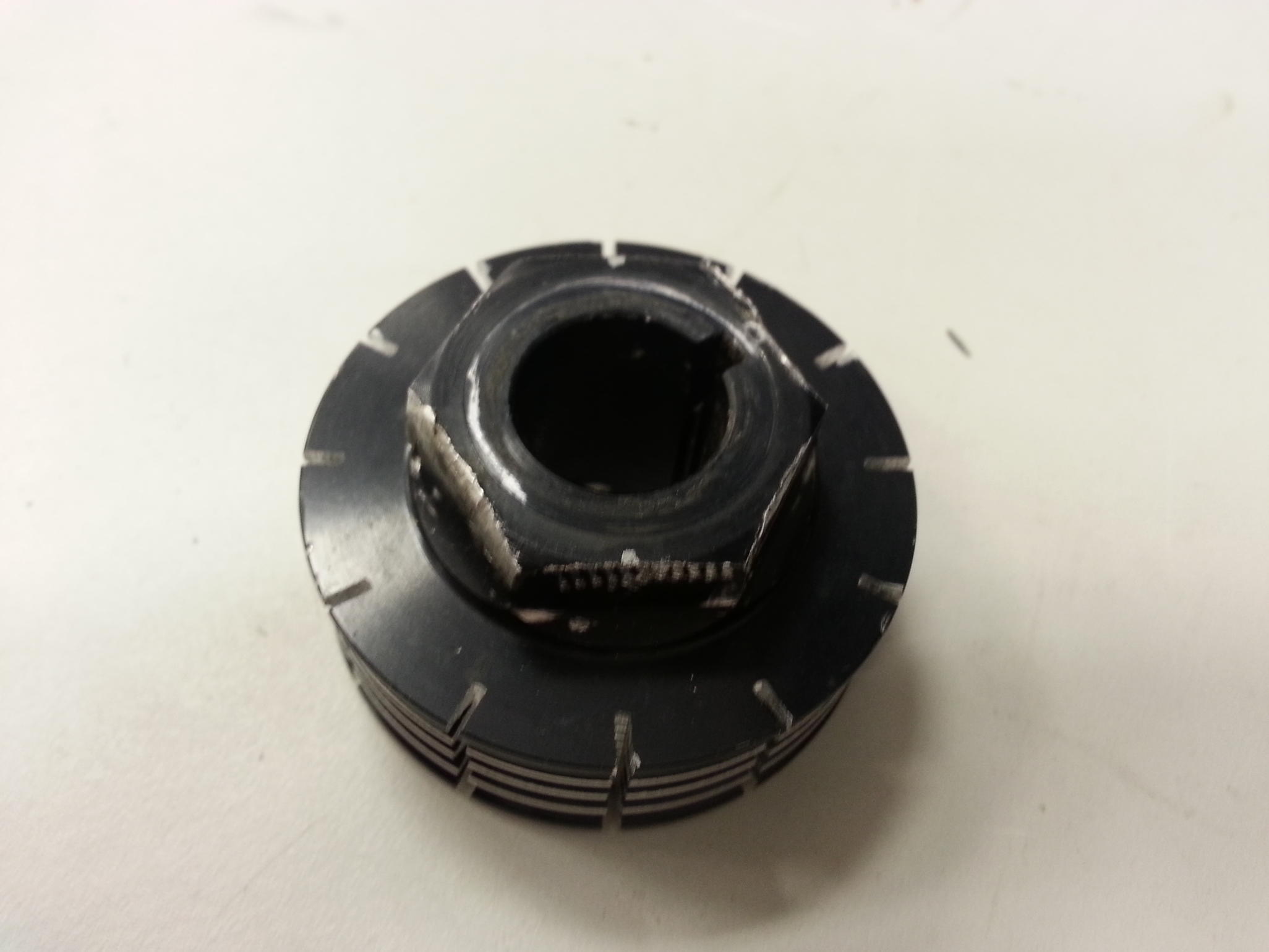

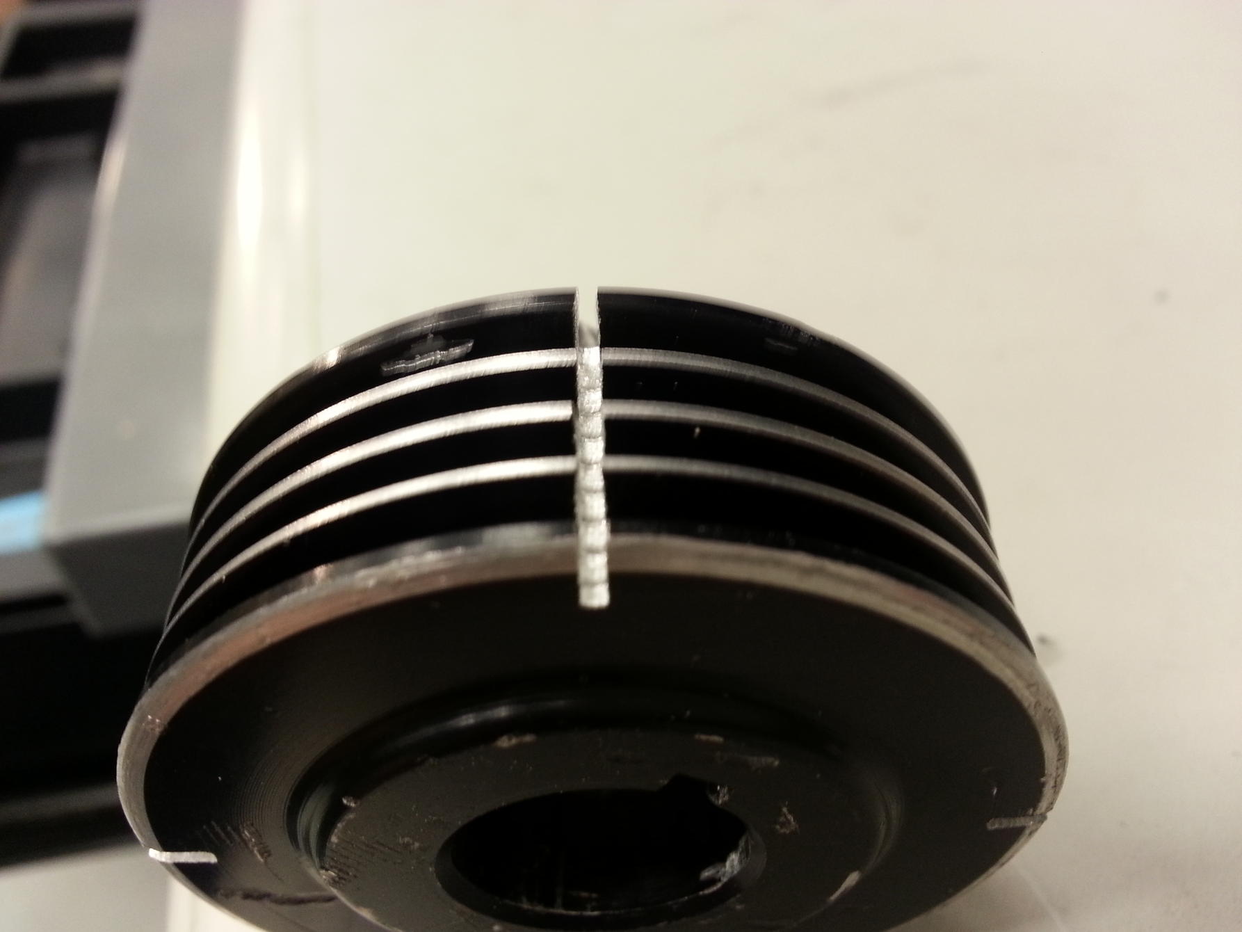

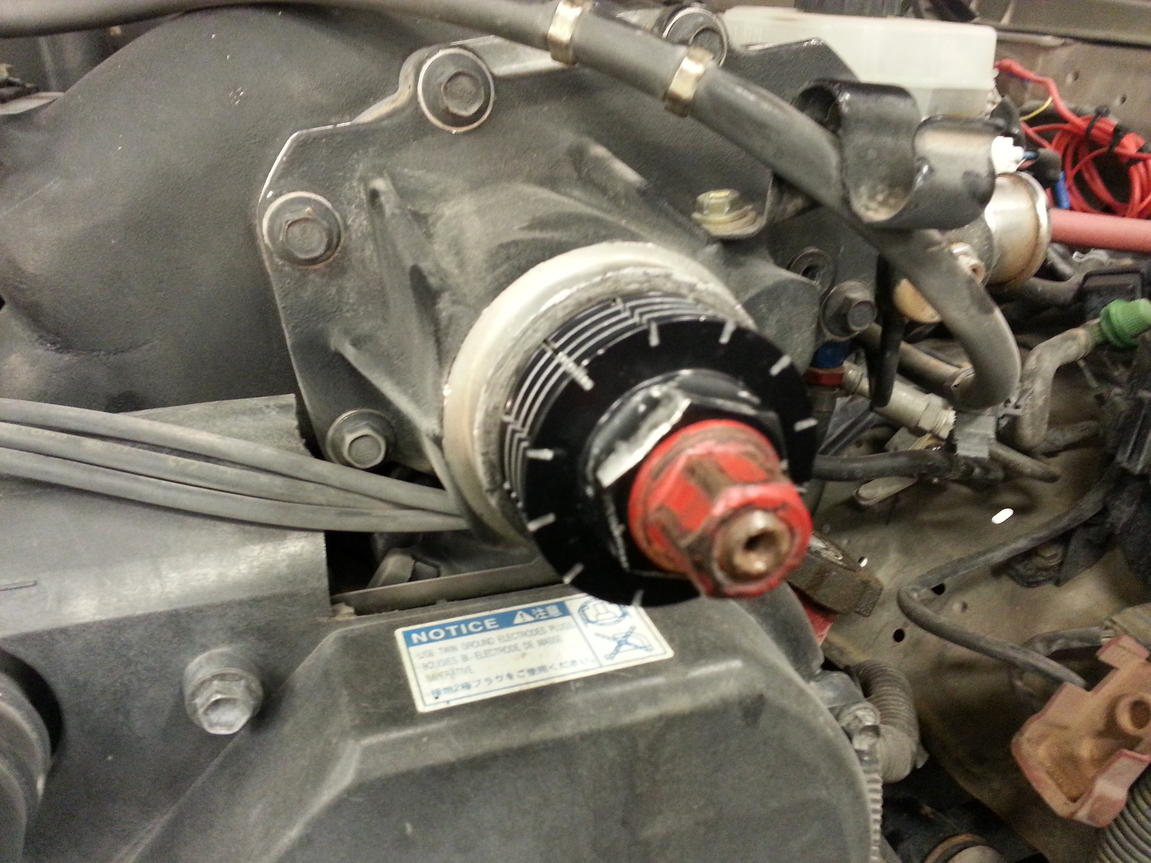

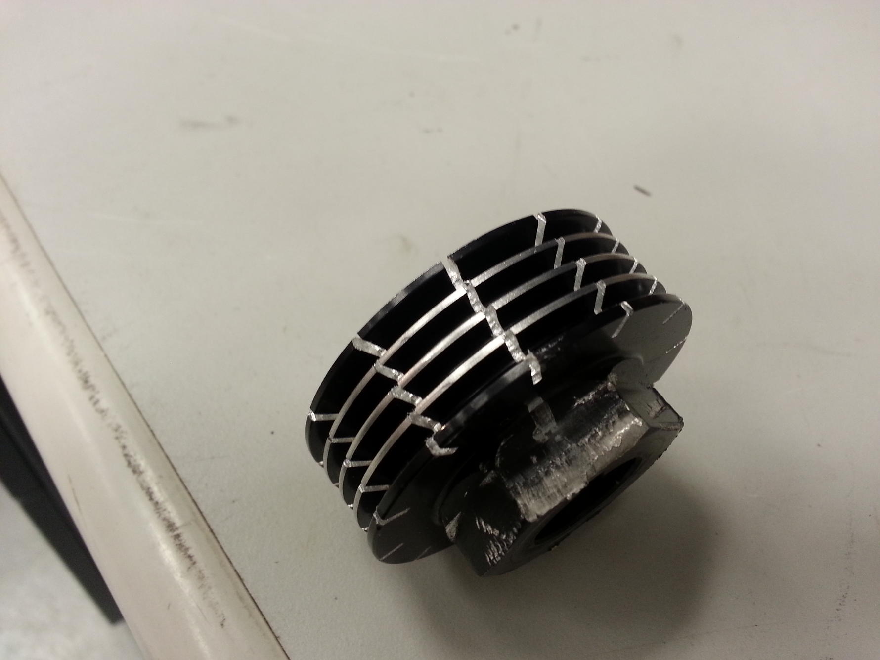

I was wondering how much boost can a stock 5vz handle? I have headers full exhaust and water meth injection to keep the detonation down. Im running this pulley and im getting 9psi of boost at 4000+ evaluation. It was slipping bad going from 7 psi to 9 psi im not sure on the size of the pulley. Now that I put these grooves on the pulley I have zero slipping. Now that I think I can take care of the slipping problem I want to have another pulley machined down and add even more grooves.

I would be careful with those grooves, they may be bitting more into the belt. It may not be slipping anymore because it could be cutting into the belt. I don't know for sure but just a thought...
I will definitely push this engine to max when I have the money to rebuild it stronger rods, crank, pistons etc. I already have another truck just incase its a 5.7 tundra so I won't be down in transportation. And I have been keeping a eye on the belt its completely ok its not eating it I also carry a spare belt just incase.

Keep an eye on the belt with those saw cuts in the pulley. Those sharp edges are sure to chew up a belt or two before getting smoothed over from wear.
I think you would find the limits of the supercharger before the engine.
Double check max speed for the rotors in the charger...
Once you get around 12 psi and up the supercharger becomes way less efficient. The 5vz can handle tons of power but the supercharger won't get you up that high, you'd need to turbo if that's what you're looking for. There's a guy on customtacos named kickergt that has a tad over 400hp on his 4wd turbo'd tacoma. He said the 5vz limit is around 450hp with stock internals, if you rebuilt the motor with all forged internals I'm sure you could push it much higher but then you're getting into tons of cash.
