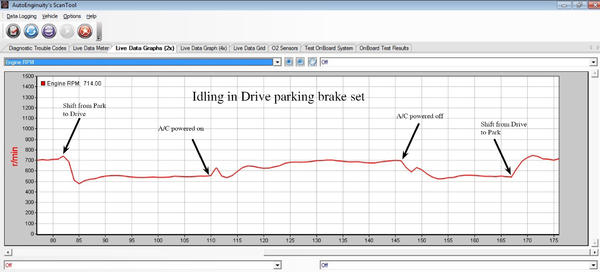

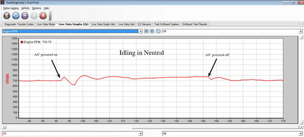

Neighbor came over last night with his car to ask me to reset his CEL. We started drinking the beer he brought, then made a run for a couple of more 6 packs and a bottle of Don Julio. As we were getting lubed I remembered this thread and we hooked the scan tool up to the 4Runner to see what effect the a/c had on RPMs.
The first screen shot is with the car idling in park and then powering on and off the a/c.
Car nicely idles at 700 rpms and when the compressor is turned on it drops 100 rpms but the car then immediately compensates by increasing rpms close to 800.
Second screen shot shows the is the same but with the car in gear.
