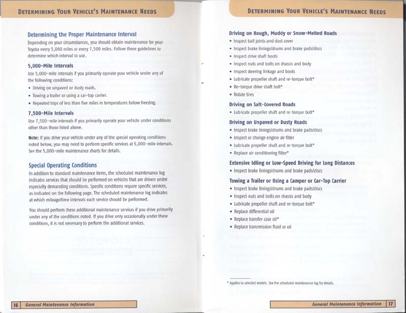

Nope, every 5K, just like the maintainence schedule says. Never loses oil, never changes color. Also lube the drivetrain joints.
Actually, Toyota does say 7500 mile intervals, unless you fall under the special operation conditions. So I'm being generous to the dealership and oil companies when I do it evey 5K.
