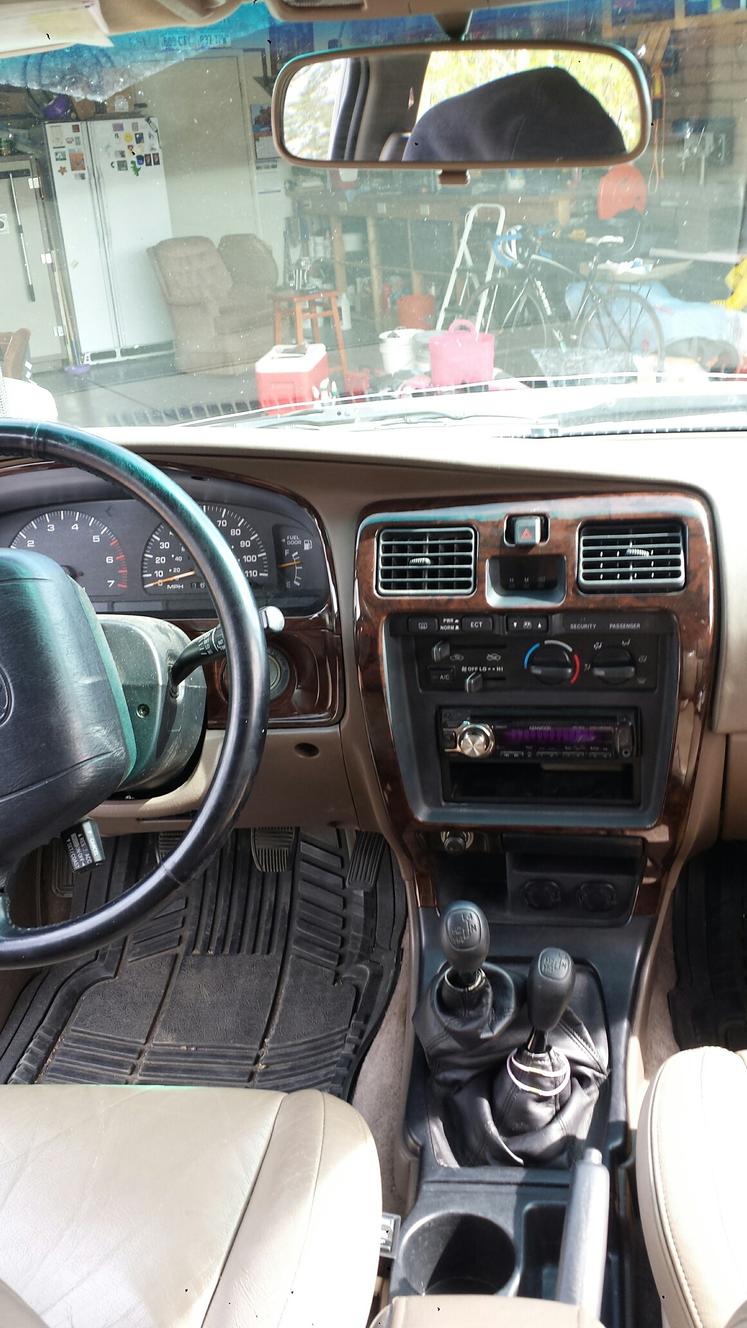

How-To: 99+ Center Dash Conversion with Wiring
Thanks for documenting.
How hard would it have been to replace the steering wheel? Mine is completely worn and a steering wheel cover looks stupid.
:nicethread:
How do I get the ebrake to fit with the new center console? Just redrill holes? How difficult is to change the ac controls on a 97 to something newer?
The ebrake from the newer style console bolts right in, and the heater controls you're pretty much stuck with, a ton of work to change.
I think it just fit, you may have to bent the bracket some or at worst redrill the front hole. And as UnderFire said, yep pretty much stuck with the AC controls. Looked into it for a bit and determined it was pretty much impossible.

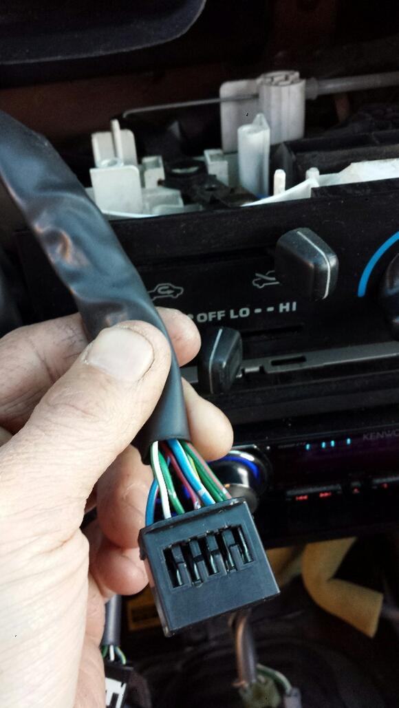

So I did this a while back and just got around to hooking up the new hazard switch today. First off a big thanks to the o.p. Seeing your write up got me moving on the wiring, thanks to the other folks that have added courage to my wrench all these years. This is the hazard plug freshly tested and ready. I've nearly got the defroster working. I'll post pics when all put back together .

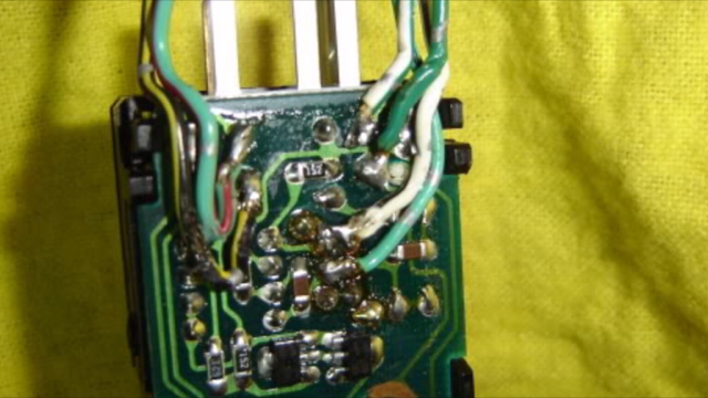

I have "solved" the issue. The problem with my solution is none of the lights for combo switch can be used.
What I learned via a thread on another site is that the IC controller for the 96-98 are located directly in the switch where as the 99-02 IC controller is somewhere else (most likely the body ECU). Because of this, you have to wire the IC board in line with the switch.
Now, I have a slush box so I wanted to retain use of the ECT button. I learned that the Engine ECU only looks for 12v from the button. Basically, if the light for the ECT lights up in the dash, the ECU switches to the different fuel/shift maps.
Here is how I wired everything up. Like I said, you have to retain the IC board out of the original switch or this will never stay on on its own.
Any questions, let me know.
First off thanks for the motivation on this writeup, I recently picked up a 2000 runner with the mentality of either fix it and drive it or use its parts to update my 97. I knew from the start I wanted the headlights, markers and the grille, and had originally intended on doing just the rear of the console and relocating my switches to the driver's side dash in the open blanks. Now that I have seen it can be done I went ahead and pulled the radio and vent piece out as well and swapped it out. This adds the 2 factory 12v ports in the dash (meaning I can get rid of my 3 port splitter in the glove box since I only ever use 1 port on it) and gets rid of my broken cup holder YAY!
For reference to anyone doing this, as he said the clock is a direct fit, just plug into the new one with your original plug, and the hazard connecter is the same as well, but wired differently. Until it's connected you will have no turn signals and if you connect it and turn on your dash lights you will pop the rear tail fuse under the hood which also disables your headlights and markers as well. Found this out tonight haha. Fortunately I keep spare fuses in my rig!
Do you have a link to where you found the info for this fix? I'm holding the IC board now and looking over it, debating on whether or not to transfer this schematic to the new board and solder in new parts and run and few traces, or just "chop" the defrost side of the board and mount this switch behind the button on the 99 multiswitch. I may also be able to figure out the lighting problem on it as well.
Also to note, you mention the ECT PWR switch in your post and talk about fuel maps, but the IC chip in your picture is for the rear defroster. The ECT power is just a toggle switch in this new dash piece. Confused on your post sortof.
Thanks in advance.
