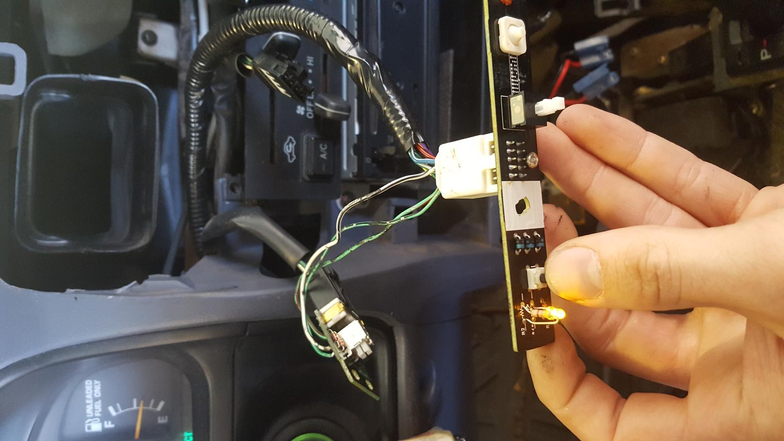

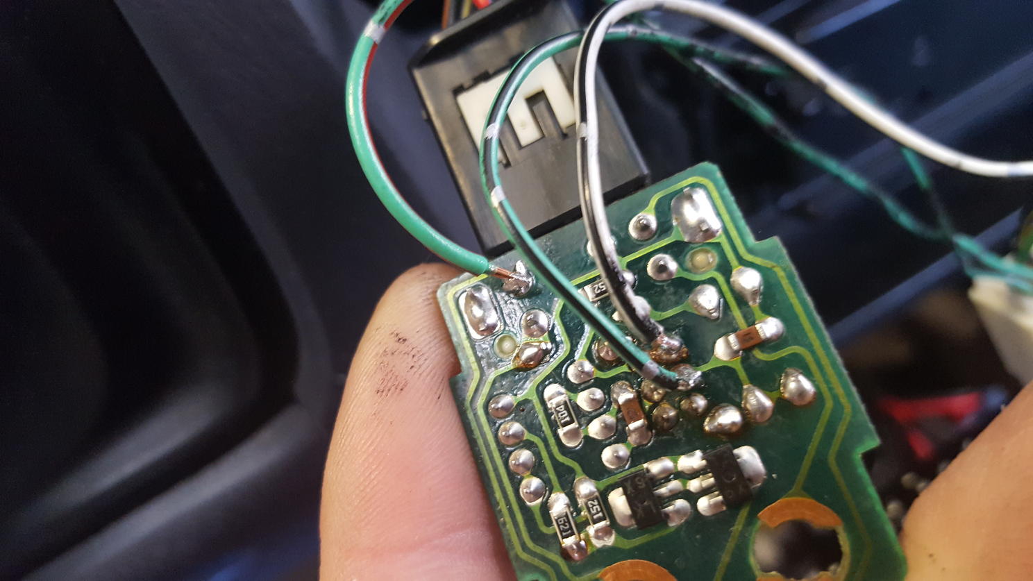

Well I've got the defrost switch taken care of, so far so good. The LED for the defrost "engage" illuminates properly and functions on off via the 2000 multiswitch. I ended up using 3 wires and soldered them to the 97 board and voila! You no longer need to keep bulbs in the original defrost switch so I remover them and used them to replace burned out bulbs in the 2k multiswitch. Now I just have to reassemble the cover on it and hide it behind my center console and good to go.
UPDATE:maybe not so much dice for the engaged led, it works initially but failed after I reassembled everything and went to test. Pulled it back apart and can't get it to work again now. So for the time being I left the Green/red wire off, and put it back together so I atleast have working defrost with 2 wires changed. I'm assume this is because the LED is probably 3-6volt draw from the ECU in a 2k model whereas the standard bulb I was tapped into is 12v. Hadn't even crossed my mind, but I'm assuming this is correct and I should have wired in a resistor prior to prevent this. That's why it worked initially but fails soon after.

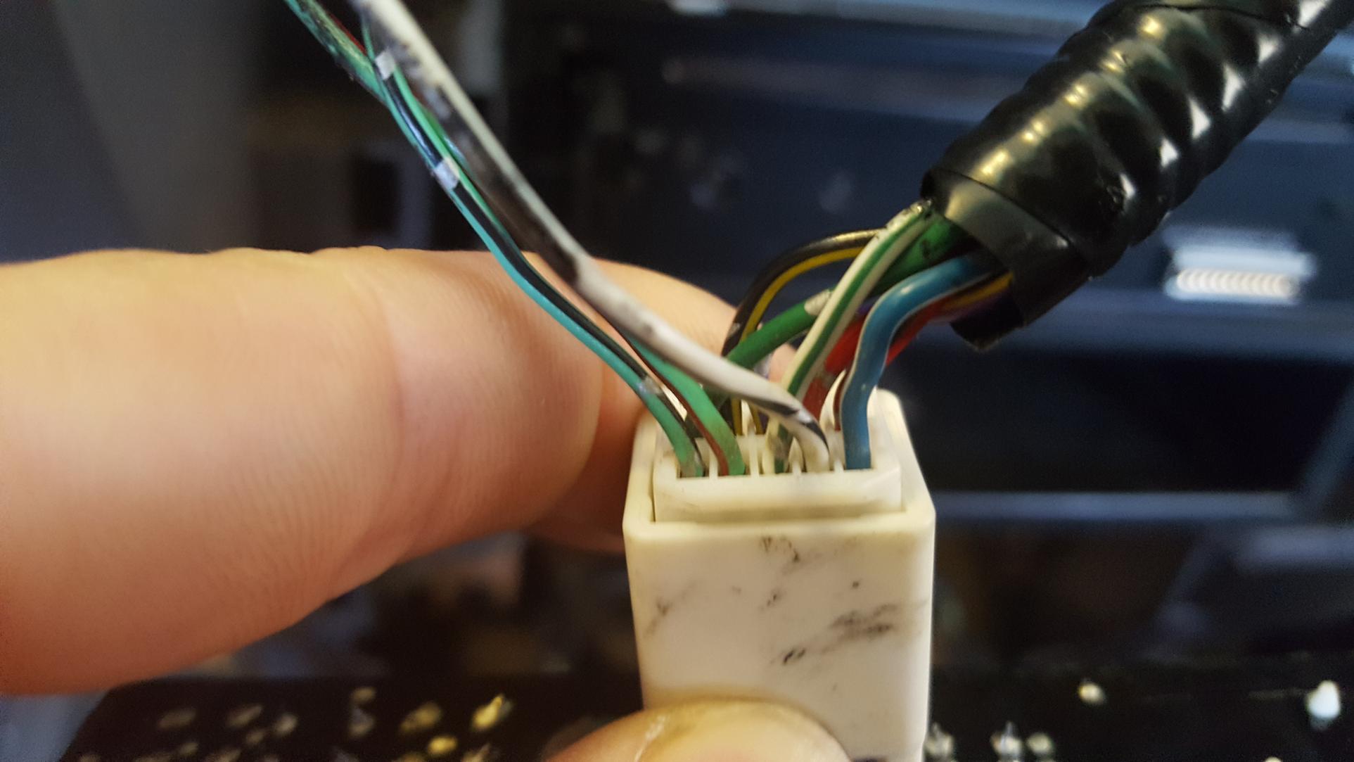

so i tackled this job over the weekend. actually replaced the entire dash as mine was beat up and cracked.
i am about to get everything put back together but i am having an issue with the hazard switch. i have the old one (97) and i have the new one with the pigtail (99).
here are the connectors from the 97.
[] WhiteGreen [] Green
RedBlack BlueRed BlueWhite GreenRed GreenYellow GreenBlack
and here is the plug/wires from the 99.
YellowRed [] GreenYellow GreyBlack
WhiteGreen Green RedBlack BlueWhite GreenRed
the 97 has a BlueRed and a GreenBlack that the 99 doesn't have.
the 99 has a YellowRed and a GreyBlack that the 97 doesn't have.
is it just a matter of matching these 4 mismatching colored wires? or?
anyone have a schematic of both? anywhere i can get the schematics of the plugs/wiring?
any help would be greatly appreciated!
I did this on my 97 with a 2k model console. I posted all my schematics a bit up in this thread if you want to compare connections. I followed Alex detail iirc and just repinned my 97 connector for the hazards.
Thanks! :thumb:it was the re-pinning the hazard switch that i missed. just needed someone else to point it out to me after reading it 100 times. :ybrick:
