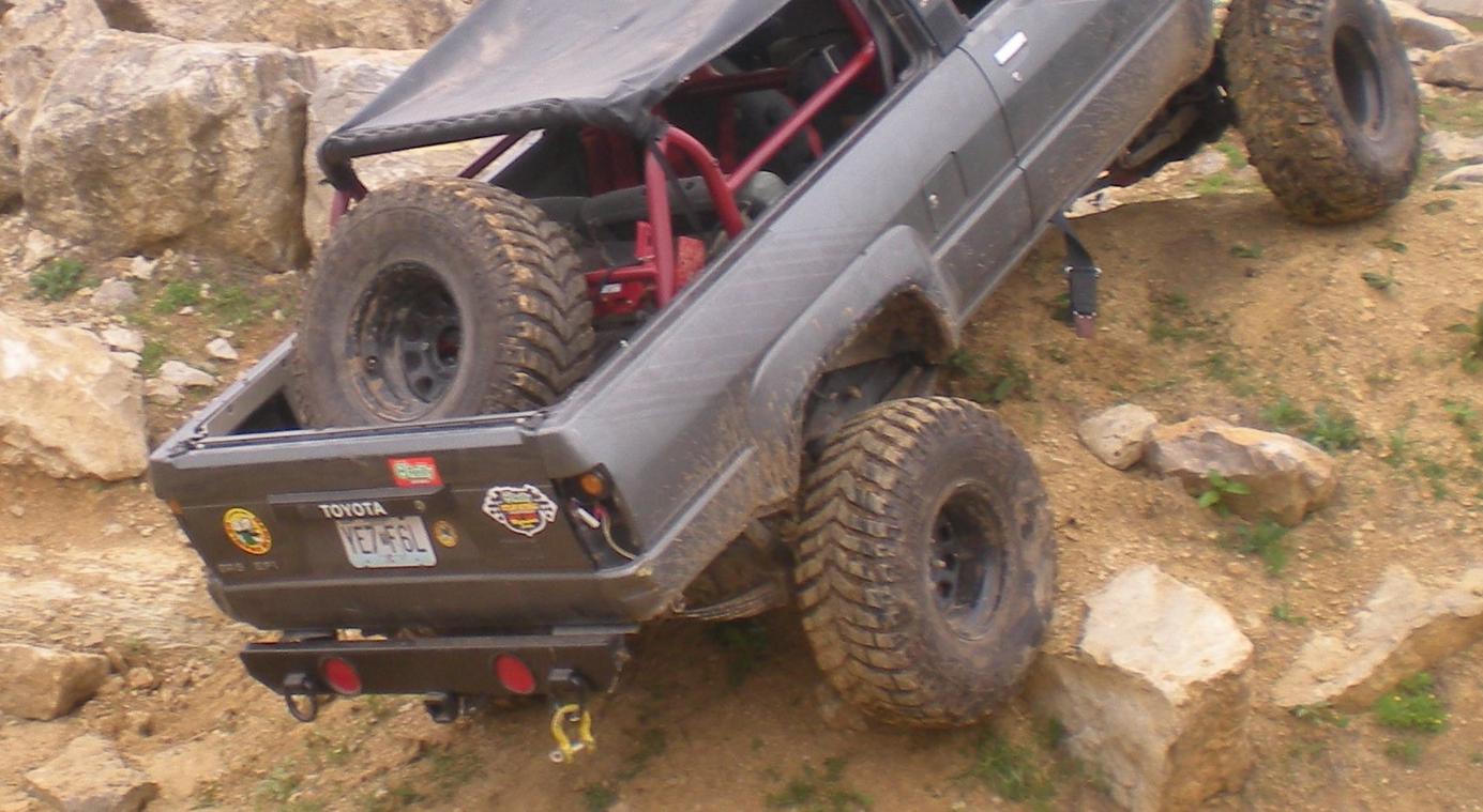

I fish mouthed then welded two sections of 1" tube across the diagonal rear bars then made a mount for my spare and my jack. I dont have any great photos.

To hold straight up, against the bars on the side, I run the ratchet straps in through between the spokes or holes of the wheel. Another strap right over the tire holding it down with the hooks in the tie downs. You might up using 3-4 straps to get it to not wooble away.
I'm not real familiar with how much room you have in the back of the 1st gens (not just yet anyway :D), but is there any way you can drill a hole through one of the bars and then run a 10"-12" flush mount carriage bolt (or even a piece of threaded rod with bodywasher/lockwasher/nut through the rollbar and then thru one of the stud mounting holes on the rim, and just lugnut it? Just an idea.

Clean, simple, no-weld, no-cut, reliable enuf, truck stays stock.
