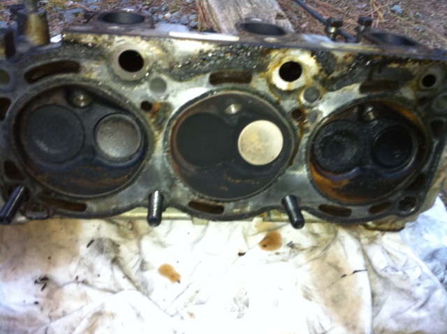

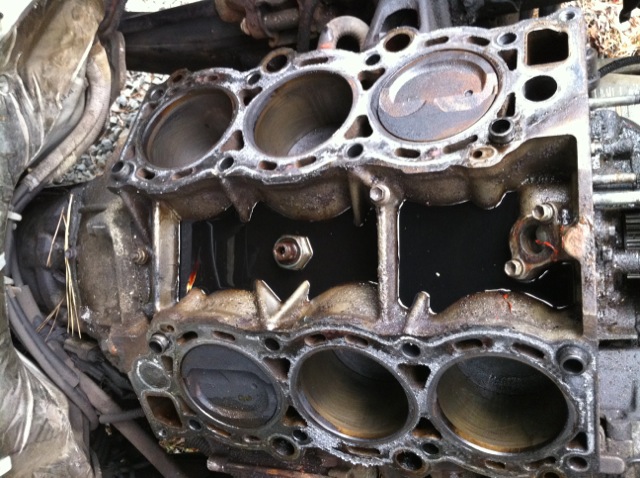

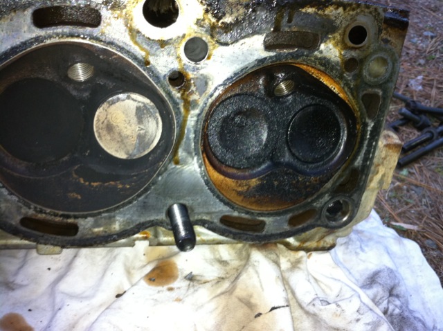

Finished pulling the heads over the weekend, have attached some photo's for everyone to look at. First thing I noticed is the valley under the intake was half full with oil. Not knowing Toyota's, I thought it may have been a plugged drain hole, then after cleaning out the oil, I realized that there was no drain hole. Seems like an internal leak from the head gasket. Is that right or wrong?
Also, cylinders and pistons looks very good, no ridge in the cylinder, and cross hatch pattern in all cylinders. No evidence of scoring or any abnormalities.
The heads are a different story, cam lobes appear to have a bit of scoring, and the journals are also showing some scoring. The exhaust valves in the #2 and #6 cylinders appear to be deeper in the valve seat then the good cylinders. How can you tell if the valves are burnt?
Anyway, have attached a few photo's, hopefully someone will see something that I am not aware of.

Also, filled up the bad cylinders with fresh oil after cleaning, and they have held, no leaking.

once you have come this far you need to have a shop resurface the heads unless you get all the gasket material off with out any major scratching and the heads fall into specs (which is rare for these motors). if youdohave them resurfaced askhow muchit will be to replace the valve stem seals and check/replace valves as needed. any reasonable shop will do all of it for 350 or less. I would also consider replaceing the heads if the cam journels are shot.

looking at the pics cylinder #1 looks like it was missing gasket material next to the guid tube... the oil says bad head gasket or cracked head.

Yeah, like I said, am new to Toyota's and their issues. Though I will say this, while the heads look like crap, the bottom end, to my marginally trained eye, looks solid with little wear. Am still deciding whether to chance it and complete the upper end rebuild and be done with it. Will let you know what I decide.
