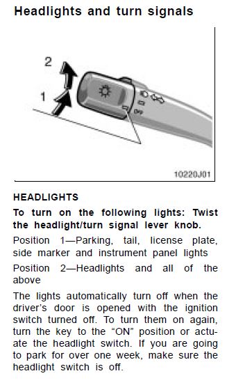

With the caveat that I set the light switch to Auto before turning engine off, then locking and remote starting, lights come on then off when I shut engine down or even if I forget and the remote shuts engine off automatically after 8 mins. If set I set light switch On after shutting off, it will stain on till the batt is dead. :cowboy:
Thanks,
you're correct, when I ask you to switch to AUTO position I mean ON position (position 2), on position OFF (position 1) my headlights shut off with engine off.
so it means we have same configuration and system works like it should. I have find the way to override it,
