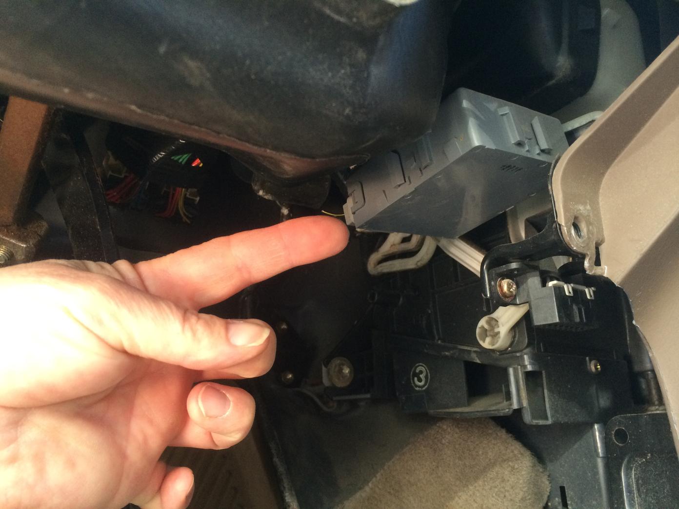

Hey SpiderMan.
Okay, so if you look up underneath your dash on the driver side you'll see a little gray box. Unplug the plug from the back of the box and cut the black wire with the yellow stripe. After you do that your DRL's are disabled.
Nope, not true. You and I have the exact same truck bud.
I've got a 97 runner 4x4 V6 limited and I was having the exact same problem you were having when unplugging that module beside the battery.

Awesome, ok thank you. I'll check it out and report back.
Yay! That seems to have done the trick. Snipped that wire and all my lights still work, but no DRL's.
I don't have to stare at that stupid Parking Brake light anymore, lol.
