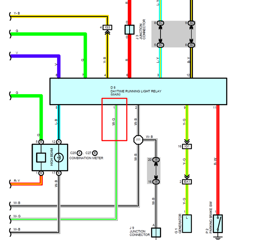

Just wanted to note for anyone this might help, another option is removing the white/green wire contact from the D8 daytime running light relay (pictured below). Just electrical tape over the contact (terminal) so it doesn't short anything but could be re-inserted into the relay connector if you wanted to easily re-enable the DRLs. Also make sure you pop the "lock" on the white connector before trying to pop the contact out with a tiny screwdriver on that white tab that grips the metal contact.

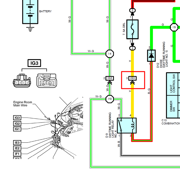

Why would this be useful?? I'm working on a project where I still need the DRL signal from the relay, but do not want my actual headlight DRLs turning on. To get that signal, I'll be tapping into the yellow wire (pin 3 of IG3, pictured below). The yellow wire goes to 12V when the parking brake is released (DRLs would turn on) or when the normal headlights are flicked on. This might be useful for making raptor lights or something similar turn on when your DRLs or headlights are normally supposed to turn on (obviously use an additional relay or something if you're gonna do that).
TLDR: Do this so your headlights still work (with Hi/Low) but normal DRLs don't turn on. You can still tap into the DRL signal to do other stuff like raptor lights.
