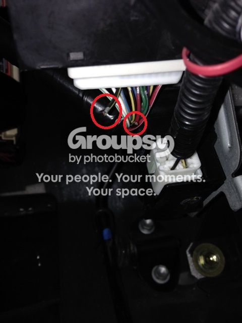

Don't you just snip the black wire with a yellow stripe? That's what I read and did. Works fine. Don't get it confused with the yellow wire with a black stripe.
It's located under your steering column just above the gas pedal, connected to a black box, just pull out the white plug and snip the wire, put electrical tape on either end and voila! I know this works on 2001's, so if you don't have an '01, do a little more research, but I'm sure it would work with most years

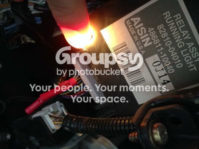

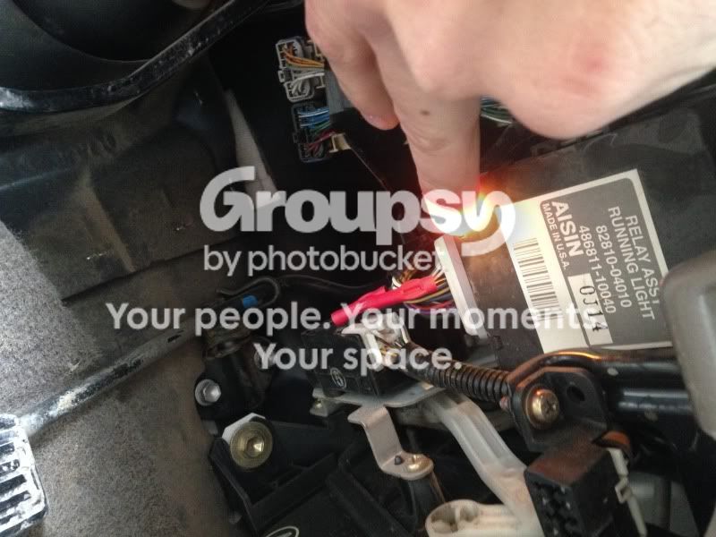

Alright guys finally got a second to take a picture of the DRL disable mod.
In the drivers footwell right above the gas pedal is the DRL control box. To cut off DRL all you have to do is cut the SOLID BLACK / YELLOW STRIPE wire and that is it. You can wire a on/off switch if you want but it is not needed as this is a disable. (I put the terminal ends on so there is not exposed wire.)
