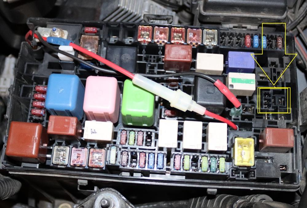

I am afraid of bursting my rear window. Is there an easy way to temporary disable rear defrost (never use it, but accidentally gets turn on when putting thing in cup holders w/o me notice etc). The fuse(#15) in the engine bay for this involve other systems (multiport fuel injection). 2003 V6. Thanks
You can in fact just pull the fuse, it is just the "defog" , pop the hood, open the fuse box just behind the battery. The defog is next to the fuel pump and unrelated... at least on this 2004 v6.
Fuse layout is on backside of the fuse box cover.
Mine has been out for a bit now, tossed it in the glovebox in case i need a spare.
$430 for new glass.
$430 for new glass.
My owners manual says different, as posted #15 fuse involve multiport fuel injection. What is the # in the one you are saying? Thanks.

...extra wires (red is not attached) were for an air compressor for the old Rancho9000 shocks.
