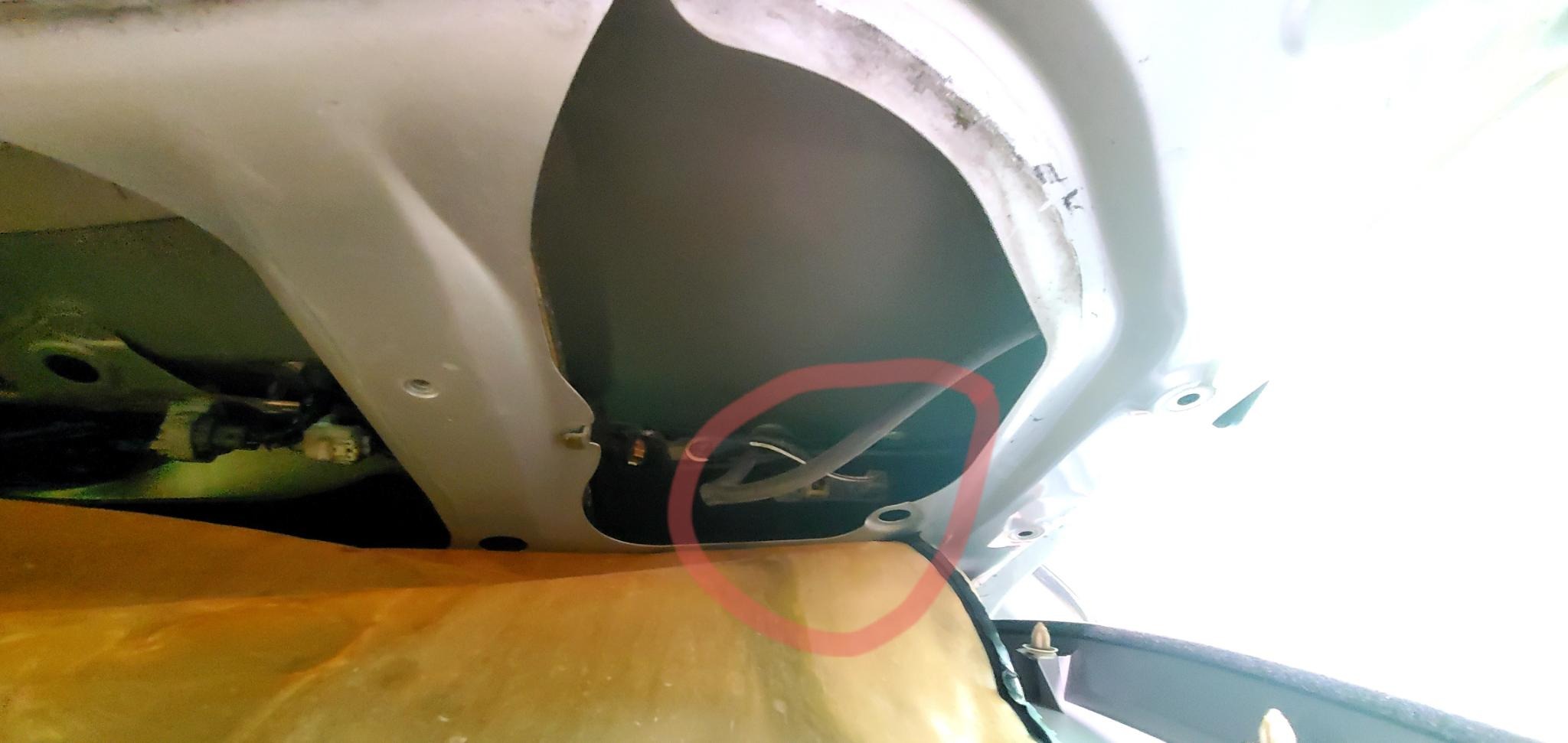

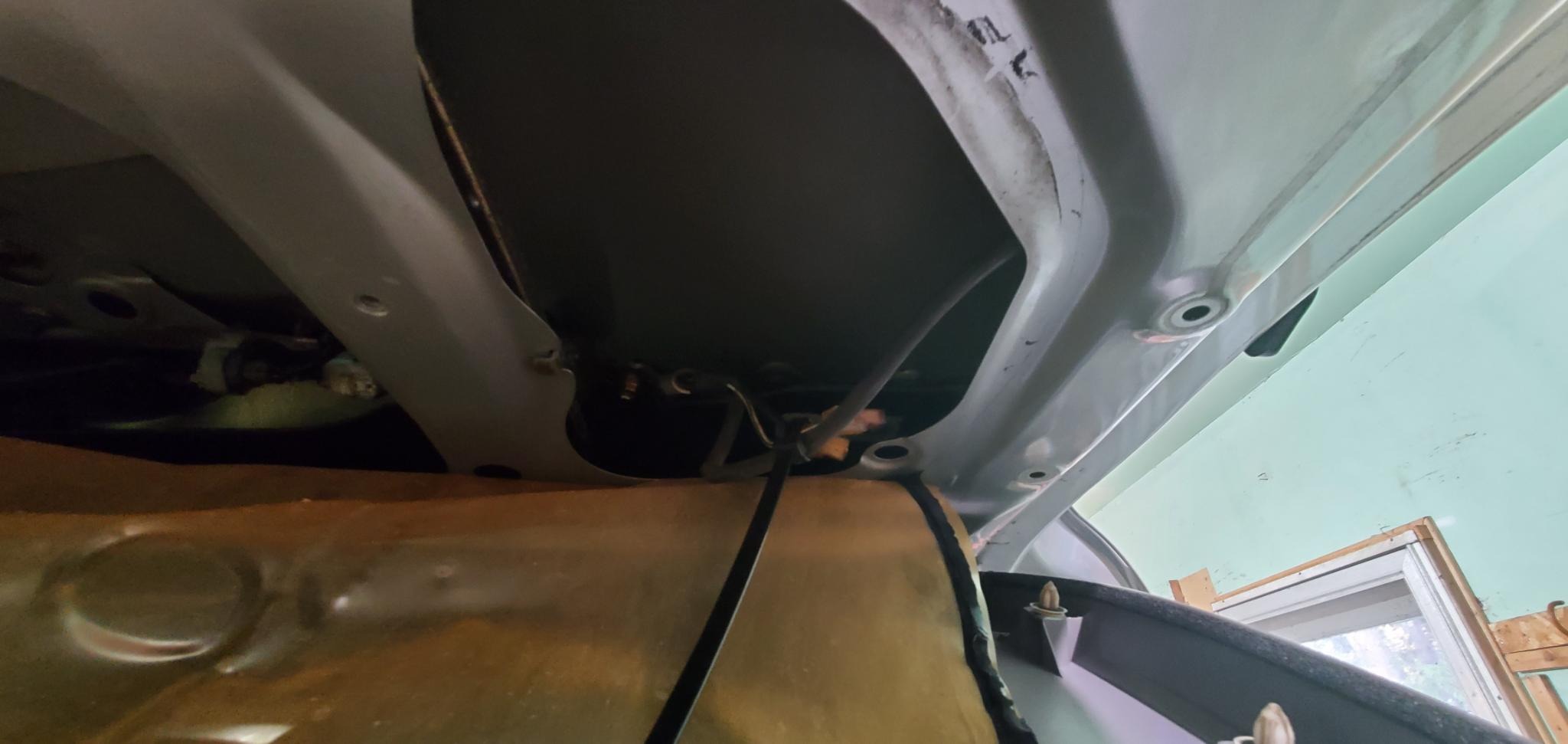

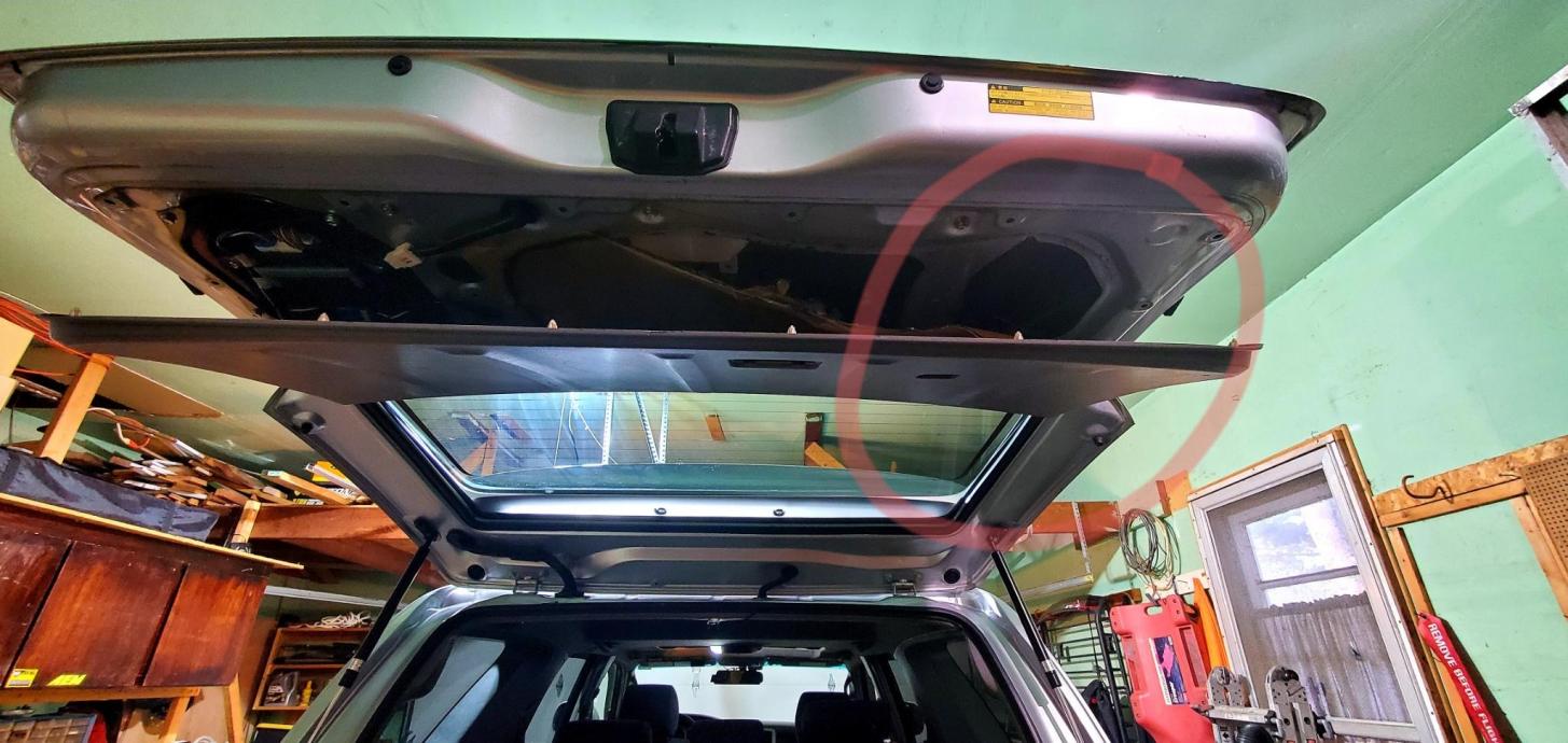

To add even more Context and some pictures... Here we go
*Step 0: roll down rear window about 1/4 to 1/2 down
Step 1: Remove inside tailgate 10mm screw on pull handle and remove the handle
Step 2 remove another plastic access panel for a place to pull from
Step 3: Firmly but carefully pull out clips for interior tailgate cover trim removal of entire cover trim is not needed as shown in the picture
step 4: gently remove moisture barrier from right side, leaving the sticky stuff intact to be reused
step 5: locate the 2 wires plugged into metal prongs on the glass in the right corner
step 6: remove plugs and zip tie to wire harness out of the way
step 7: reapply moisture barrier and put everything back together
Total time: 2 minutes and 30 seconds
Value: Never need to worry about glass exploding
Heated mirrors still work
