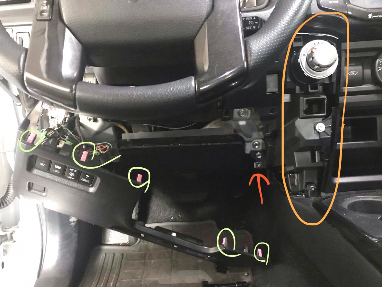

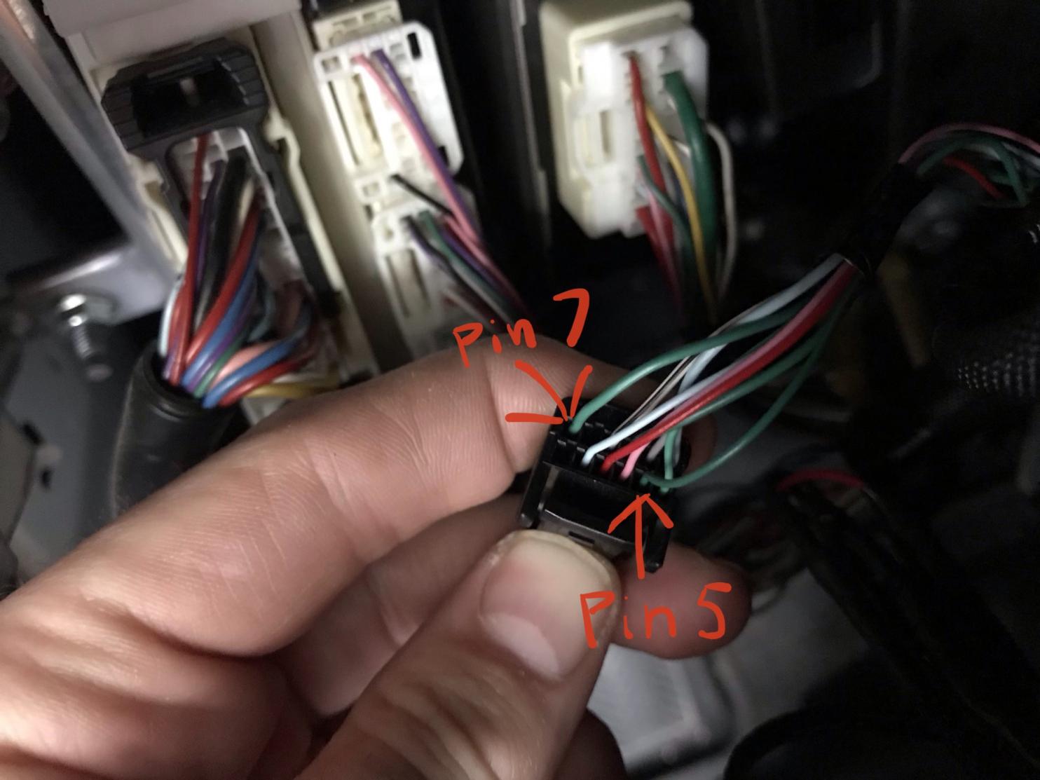

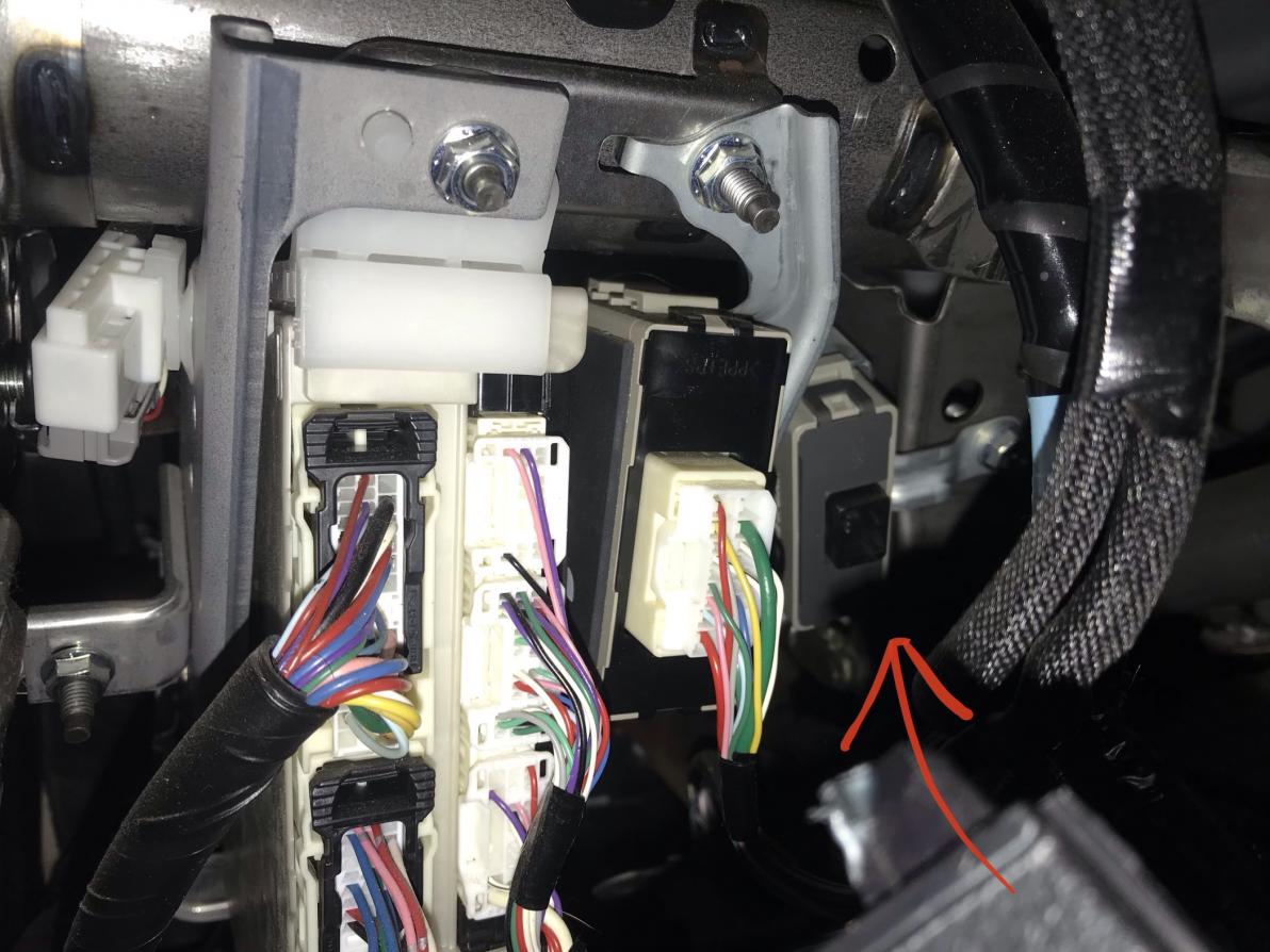

If anyone is curious how to disable tpms in a 5th gen it’s super easy. I noticed there were write ups on 4th gen’s but not 5th gens. The idea is simple and can be acccomllished in many ways but you basically just send a 12v ign to the dash bulb keeping it from grounding, so the light never comes on. Just take off the lower instrument panel, which requires you pull off the piece circled in orange, remove 2 10mm bolts (red arrow), there’s another one on the left you can’t see, it’s behind the little kick panel that you need to mostly remove to get to. Then it’s just the clips in green. Then you just Find the tpms module. There are 4 modules/rows of connectors. This is just left and below the steering wheel. The farthest right one, it’s brown/grey with a black connector, is the tpms module. It’s bolted to the dash with a single bolt on a silver bracket. Grab the plug and cut the green wire in pin 5 (Count from left to right, looking at the back of the connector, starting with the blank space) and connect it to the green wire in pin 7 and done. You can use a quick tap, or strip and solder. And bam. Your done. Now the tpms light will never come on. I’m just not a fan of the expense that comes with tpms. Tpms is a safety feature as a significant percentage of accidents are attributable to flats ad. Low tire pressure but I’m a grown ass man

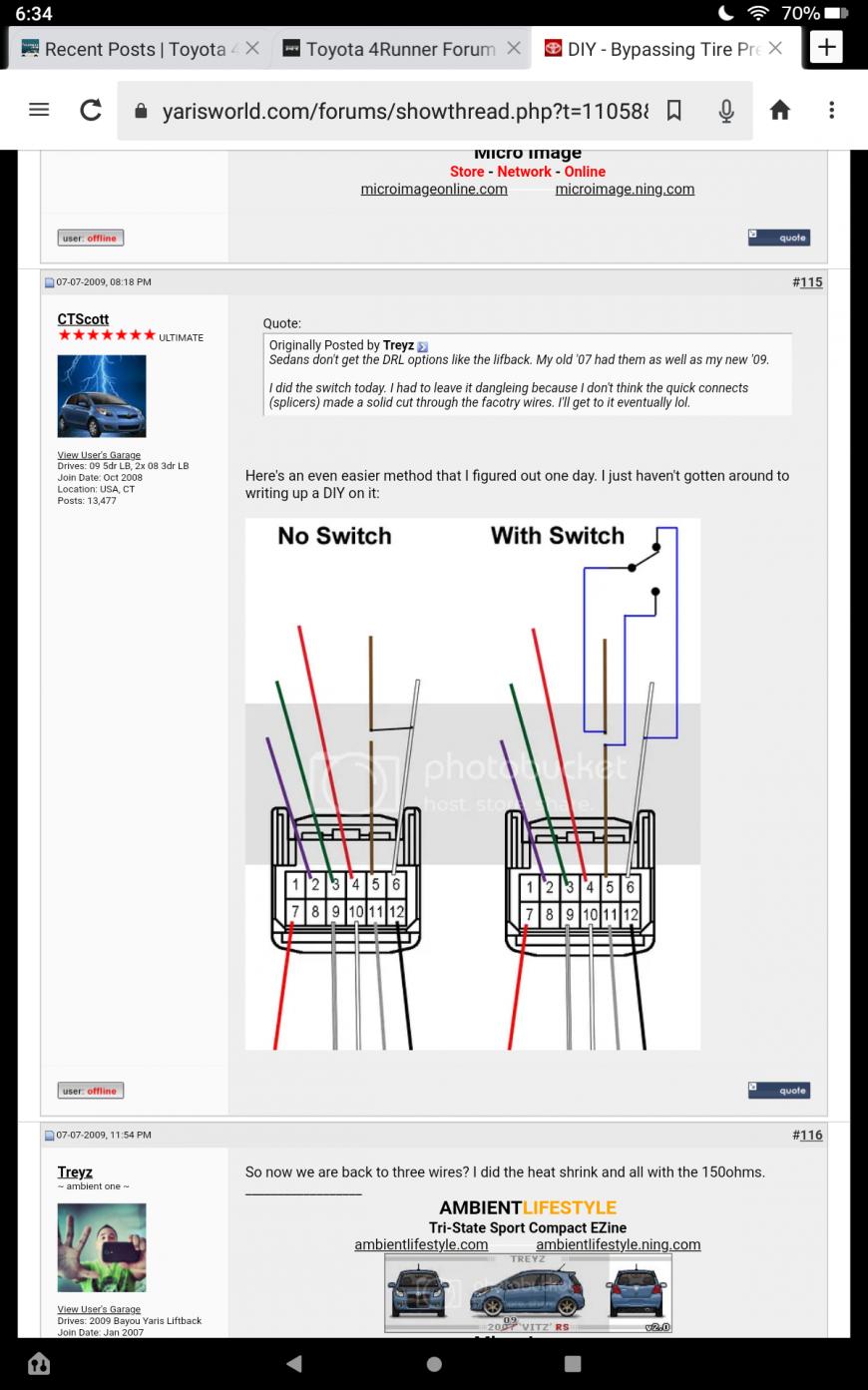

I did the toggle switch TPMS mod in my 4th gen, and I’m very happy with it. I have wheels with the factory TPMS and wheels with aftermarket TPMS. I just flip the factory TPMS off when I’m using the aftermarket sensors.
Somewhere in the 5th gen procedure, I assume a toggle switch just needs to be spliced in somewhere. (I’m not an electrician, so please correct me if I’m wrong.)

Sound like the yaris tpms work around. Reminds me i need to add the switch to the woman's car this weekend.
