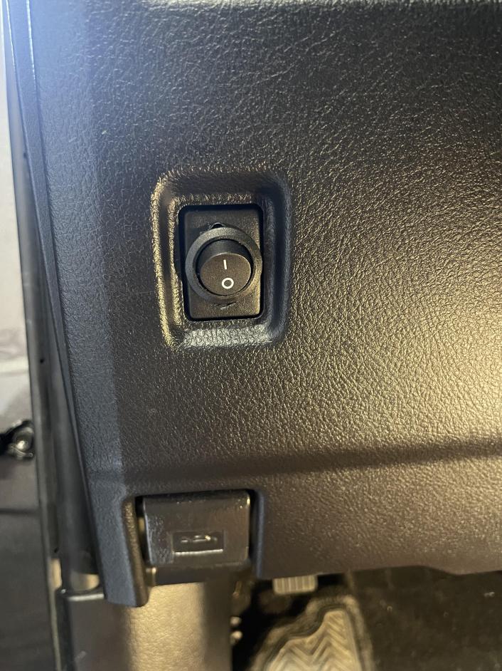

If anyone is curious how to disable tpms in a 5th gen it’s super easy. I noticed there were write ups on 4th gen’s but not 5th gens. The idea is simple and can be acccomllished in many ways but you basically just send a 12v ign to the dash bulb keeping it from grounding, so the light never comes on. Just take off the lower instrument panel, which requires you pull off the piece circled in orange, remove 2 10mm bolts (red arrow), there’s another one on the left you can’t see, it’s behind the little kick panel that you need to mostly remove to get to. Then it’s just the clips in green. Then you just Find the tpms module. There are 4 modules/rows of connectors. This is just left and below the steering wheel. The farthest right one, it’s brown/grey with a black connector, is the tpms module. It’s bolted to the dash with a single bolt on a silver bracket. Grab the plug and cut the green wire in pin 5 (Count from left to right, looking at the back of the connector, starting with the blank space) and connect it to the green wire in pin 7 and done. You can use a quick tap, or strip and solder. And bam. Your done. Now the tpms light will never come on. I’m just not a fan of the expense that comes with tpms. Tpms is a safety feature as a significant percentage of accidents are attributable to flats ad. Low tire pressure but I’m a grown ass man
I’m getting ready to do this and am wondering which end of the number five wire you splice to number seven? I assume it the “long end” not the short end that would come off the plug. Is that correct? To help clarify what I’m saying, if you pulled the wire out of the connector, you would only have the long end.
Old post I know... but a great one! Would this work for my 2013 SR5 4runner. My TPMS is NOT behind the glovebox, I have looked. Thanks a bunch!
