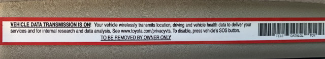

My truck came with this sticker, affixed to the upper center console, near the off-road controls and the SOS button. Rather spiffing of Toyota to include it, I thought.
attachment.php
Having never taken any action to opt in to any of the connected services, I was not sure what would happen when I pressed the SOS button, but when I did so I was connected to a very nice lady who, when asked how the DCM could be disconnected, told me it was not connected as I had not yet opted in. I pointed out to her that there must be some level of connection, as we were speaking. She seemed then to gain a sharper understanding of what I wanted. She told me I would have to download the Toyota App to my phone and create an account so that I could opt out. This idea of creating an account to opt out didn’t seem right, and I said so. She politely gave me a phone number to try. It was 800-331-4331. This is not a number for Toyota Connected Services. It’s the number for Toyota Safety Connect. (Evidently they are different.)
The gentleman I spoke to there was not so cordial. Once he understood what I was after he became very gruff. He explained that he had worked for Toyota for decades, and if he thought Toyota would mis-use my data he wouldn’t be working for them. And he warned about all the features that would be lost if the DCM were deactivated, that the vehicle would lose “all radio communication” and that in order for those functions to be restored I would have to take my truck into the dealer and pay to have the DCM “re-flashed”. All radio communication? What about the traffic and weather data? What about the key fob? He would not be specific. I’m not sure he knew the details. I also expressed my thoughts that while Toyota’s motives might be pure, they could be just a piece of legislation or a court order away from being compelled to share my data, and that the possibility of my data falling into the hands of hackers also exists. Ultimately, as our spirited debate wound down I decided not proceed at that time. I decided to wait and conduct a few tests to see just how much functionality I would lose. .

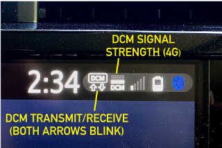

Before we go further let’s look at the feedback we have with regard to the DCM by way of indicators on the upper right corner of the infotainment screen.
attachment.php
Going from upper right to left: The BlueTooth symbol shows that there is a Bluetooth connection between the infotainment system and my smartphone. Next: the battery level on the phone. Then: vertical bars indicating the current cellular signal strength on my phone. Next: horizontal bars indicating the DCM’s cellular signal strength. And finally the DCM transmit/receive indicator. The rectangle with the letters “DCM” is always present. When the system is sending or receiving, the up/down arrows will both blink on and off. I was lucky to get this photo - it is rare that the arrows blink, and I just happened to catch them one day. Later I learned that you can force them to blink. On the infotainment system press Menu —>Setup—> General—>Software Update and press the “Check for Software Update” button.

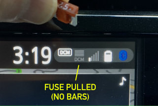

So I wanted to test what would happen if I pulled the DCM fuse:
attachment.php

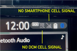

The first thing I noticed is that the DCM cellular signal indicator now read no bars. I had read elsewhere that some folks who had pulled the fuse lost one of the speakers, and the hands-free microphone in the upper console. In the case of my ‘22 ORP, all the speakers worked fine, but the microphone did not work. I know for lots of people this is not an essential feature, and for them perhaps pulling the fuse is the best way to go. But for me the microphone is a must-have. So I replaced the fuse and determined to investigate further. By the way, with the fuse pulled, all the key-fob functions worked perfectly, and the weather data was available, and the traffic showed up on the navigation screen. So I guess those bits of data come in over the HD radio rather than through the DCM.
For a couple of weeks I drove the truck normally, just observing the behavior of the DCM, trying to get an idea of how often it connects. One day I was driving in a deep canyon. There was no cell service there - neither the 5G that the phone uses, nor the 4G that the DCM uses.
attachment.php
When there is no signal the bars are crossed out.

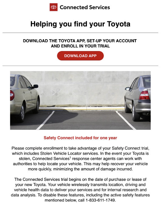

Then I got an email from Toyota reminding me that I had not yet opted in to all the great connected services. It included a number to call if I wanted to disable them.
attachment.php

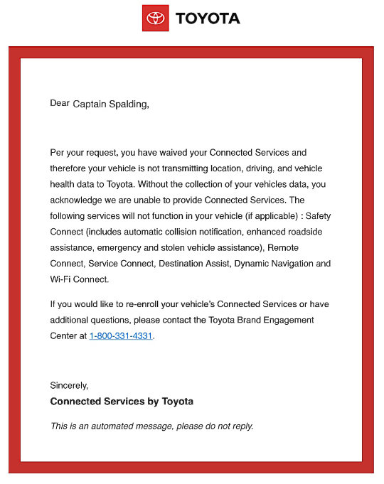

So I called this number and had the DCM disconnected. Later the same day I got the following email:
attachment.php
The email says my truck won’t be transmitting any data. It’s in writing, so perhaps there’s some legal weight to the claim that they are not transmitting my data without my consent. The number at the end of the email to re-enroll for connected services is the same number at which I spoke to the grumpy gentleman who said if I wanted to get connected services back I’d have to take my truck to the dealer, and that restoring those services couldn’t be done remotely. I find this encouraging. I performed a couple of other tests. I tried the software update check, and the up/down arrows didn’t flash. I also went to the “Software Update Settings” menu item, which presents a button that says “Auto Update Check”, and that button is disabled, stuck in the off position. Finally, I pressed the SOS button, and a recorded voice said “The communications module is not active. To sign up for service please call …” The message, I’m sure, is in the DCM’s firmware, and wasn’t transmitted to the truck from elsewhere.
