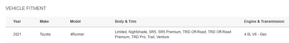

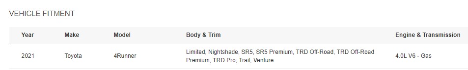

I ran the part number through the Toyota dealer's web site and it confirms that these sensors will work with your vehicle:
