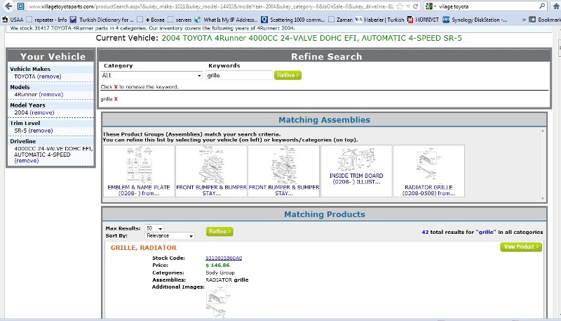

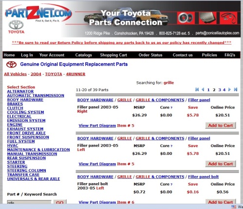

The best on-line diagrams that give you both the Index (reference) number and the corresponding OEM part number (stock code) can be found at the Village Toyota Parts site. All of the other popular places (Conicelli Partznet, Toyota Parts Cheap) will show you the Index number and let you order the part but you'll never find the part number.
Regardless all of the sites will allow you to search for keywords. I like the Village Toyota site the best because it puts up thumbnails of all of the related diagrams that have a match for your keyword search. If you're searching for a part that has a similar name to parts used elsewhere, you can quickly identify the correct part of the vehicle from the diagrams and locate your part. I attached a couple of screen shots so you can see the differences in search results.

disclaimer: Although I mention them frequently, I have never shopped with Village Toyota. Their prices are slightly higher than Partznet and Partznet customer service is great so I normally look up the part number on Village Toyota and order from Partznet.
