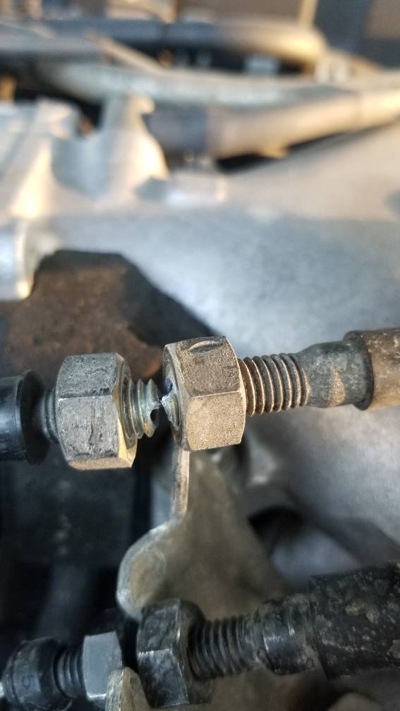

Whoops I made a mistake and snapped my transmission lockdown bolt, does anyone know a replacement part?

Yikes! How hard did you torque that sucker down? I can't seem to find a part number anywhere though.
If I remember correctly, one end connects to the throttle body and the other end connects inside the transmission to the valve body. I remember having to disconnect it when I removed my valve body.

So I just loosened the left one and it snapped asap they were corroded together lol. Fixed temporarily with zip ties
