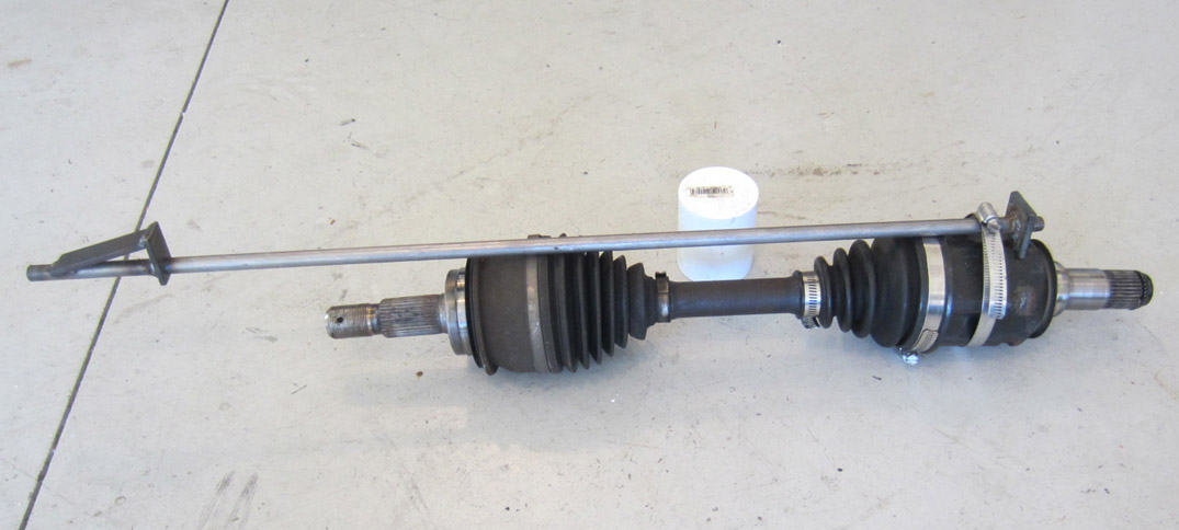

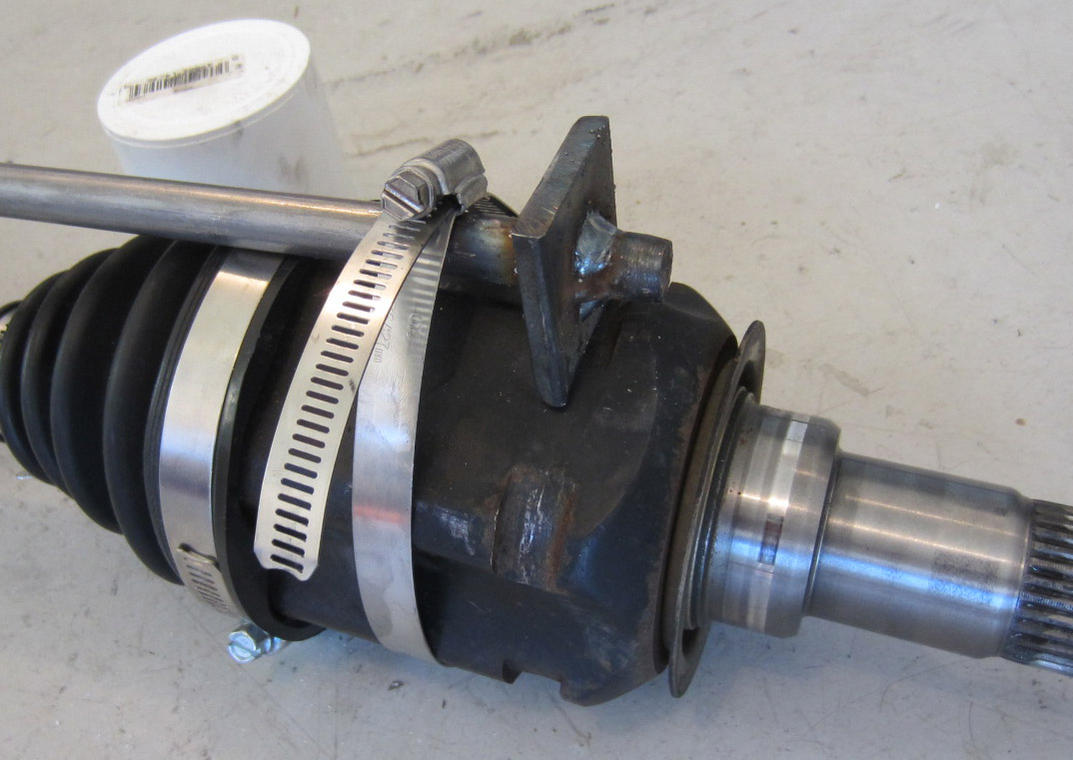

Are you able to get them started? I had to hammer mine pretty hard to get it all the way seated. I used a 1/2" steel rod with a small plate welded to the end and used a large band clamp to hold it in place while I whacked the end with a 5 lb. hammer. FWIW I installed mine with the clip opening facing down.

Here's what I used. I didn't have anything handy for a slide weight, I just made a ramp at the end to whack with a hammer when pulling out the axle. A slide would have been better. The white thing in the photo is a 2" PVC coupler with cap, used to install the driver's side oil seal.

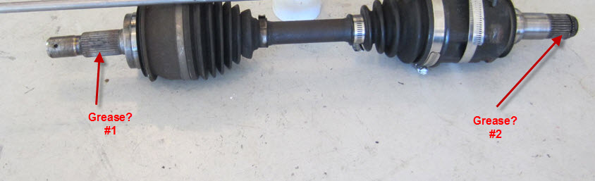

As BGR mentioned, grease the splines on both ends, you don't need much.

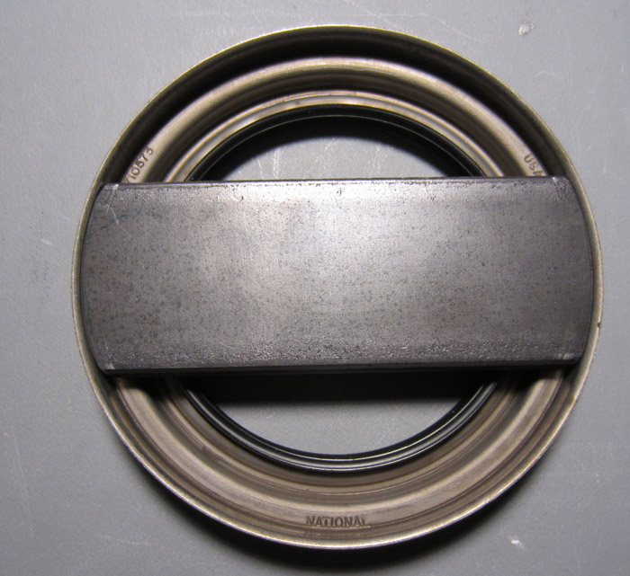

Anybody have a good DIY seal driver to fit the knuckle seals? I didn't replace my drivers side, it didn't get damaged when I removed the axle, but I have 'em in case it happens. Still trying to come up with a suitable method to install one if I need to on my other axle.
I don't know if I'd call this a good knuckle seal driver, but it's what I used. It's 1-1/2" x 1/4" with the ends ground to fit inside the 3.84" diameter seal.
Nice. Hey, if it worked, I'd call it good. I have some old edger blades that I might be able to grind down. I also thought of just cutting out some wooden circles to fit the diameter. Or I'll just talk to a buddy who welds and see if he has some scrap bar stock.
