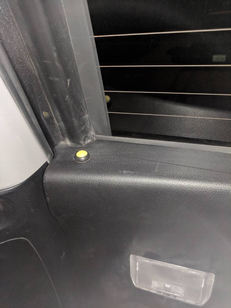

I regularly camp and sleep in the back of my 4Runner, and it's a pain to get out of the side doors or roll down the back window to open the tailgate, so I wanted to install an interior tailgate switch.
This write up is great, but it's not applicable to 5th gens:
http://www.toyota-4runner.org/4th-gen-t4rs/70995-interior-rear-hatch-release-button.html

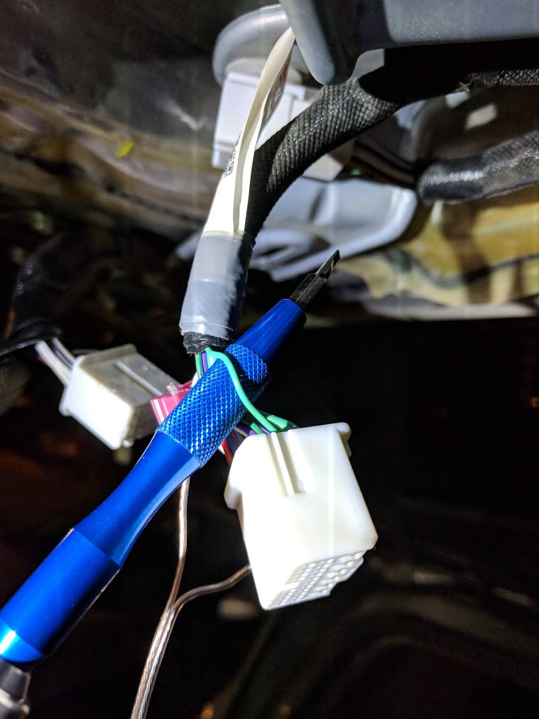

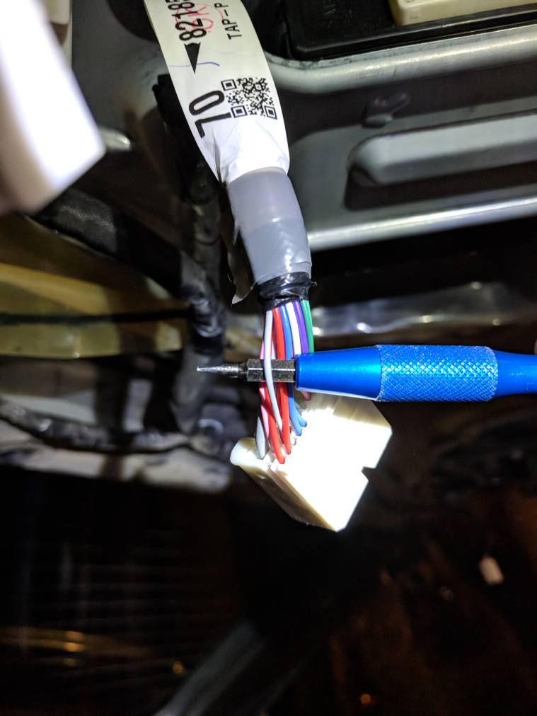

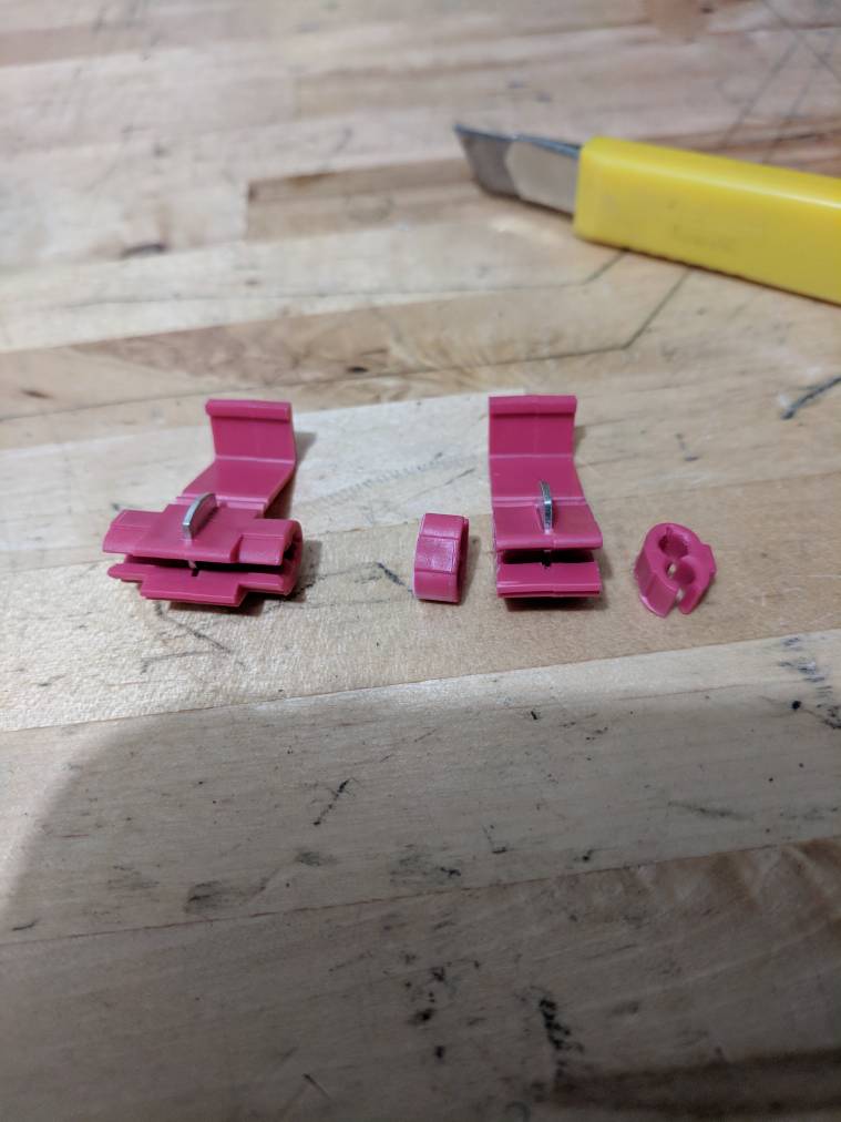

For 5th gens, follow that write up, but instead of splicing into the wires he mentions, splice into the light green and grey wires as shown in the attached pics. I used standard red splices with the ends chopped off so they fit between the connector and the harness sleeve.
I only installed the momentary push switch, and not the toggle switch. I figured the tailgate doesn't open when in drive (I think) and the hidden location would prevent it from accidentally opening when in park. You need to push the tailgate while holding the switch down so it's a 2-hand job as it is.

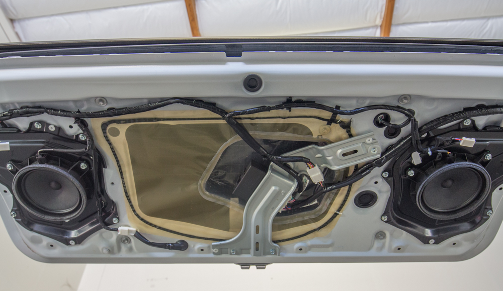

Thanks for this writeup! I am going to do this to my 18 4runner this weekend. If its not too much trouble can you help clarify which connector you spliced into is? The pictures from the original thread you linked are no longer visible. It just says the rear door ECU. I think this is what it looks like in the 5th gen when the panel is removed but it is not immediately obvious which connector is shown in your close up pics:
I assume the ECU is the black Electronics package in the middle of the door, but I am not positive and there are two connectors to it.
Maybe it will be obvious when I open it up...? Or maybe there are only one light green and grey wires in either connector..?

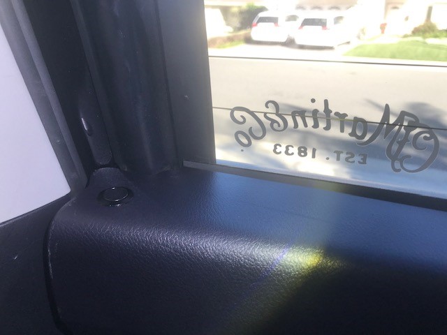

Figured it out and wired it up this weekend. This is so cool. What a useful mod for those of us who sleep in the back. I did not have to disconnect the battery and it was pretty easy to figure out what harness it was. It was labelled 70 just like the one shown above. Here is a picture of my switch. I think this switch looks great. Almost looks factory.

No. It doesn't matter. All the switch is doing is connecting the two wires when pressed. So just connect a splice off the light green to one connection on the switch and a splice off the grey to the other connection on the switch.
The scariest part for me (I haven't done this before) was drilling a hole in the plastic panel. But you can make sure the switch is working and all is good before taking a drill to the panel. Also I tested the diameter of the drilled hole required by using a scrap board first. The old measure twice cut once principle.

That's what I figured but thanks for the clarification! I ordered that same switch already but in the silver color. I figured when the hatch is up you won't see the switch, and no one normally would see if that sits in the back seat.. but if I need to get out in the middle of the night to pee, I figured having the switch be more visible may be helpful... who knows, lol.
