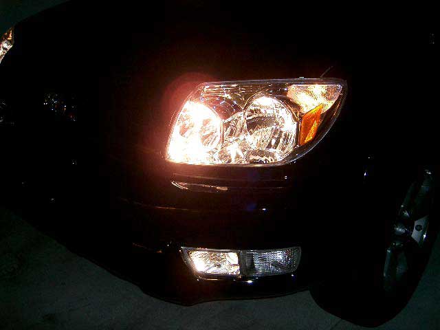

thanks guys ... 5 minutes mod
It's pretty cool isn't it!
I'm so glad I did this, I love watching other 4th Gen owners drive by, and they noticed my fogs on, with my headlights off. You know they are messing with the switch trying to figure out how I did it (lol)
