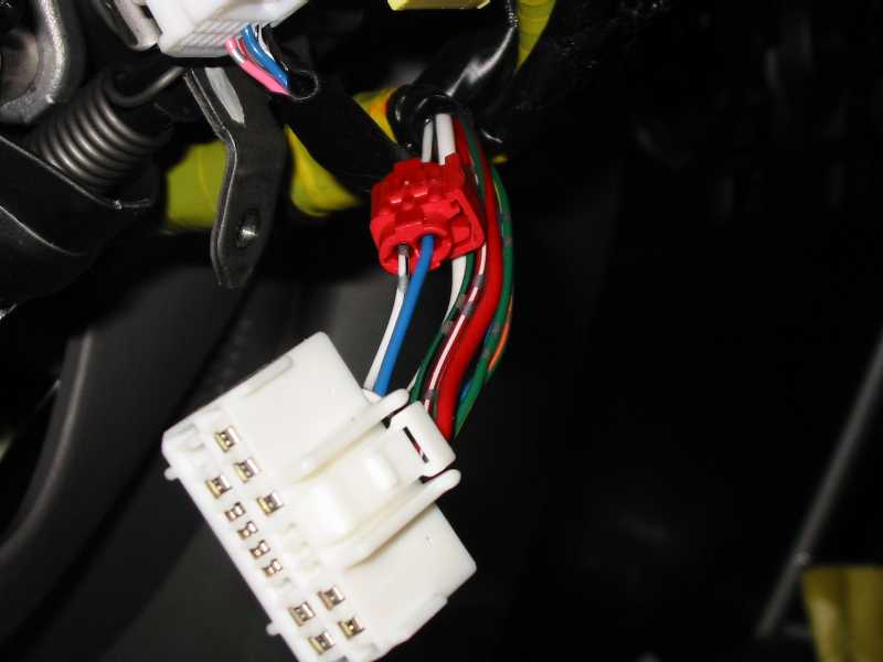

Thanks for the directions to get into the steering column cover. Did Part 1 of this mod by tapping together wires from pin #2 (GND) and #17 (switch gnd) at connector C12. Wrapped it up so its neat and clean.
pic - Part 1

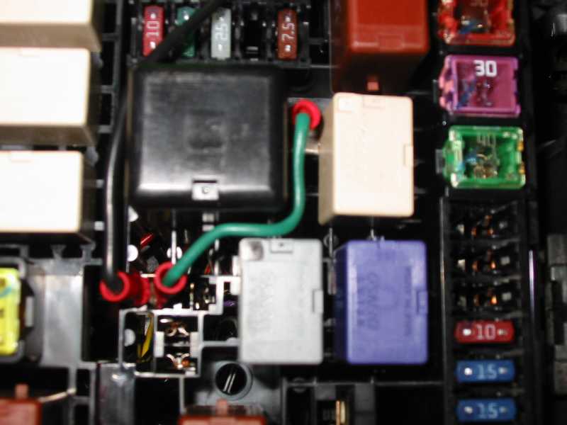

Then in the engine bay fuse block. Did it slightly different than RXvedub. Removed the front fog relay. Carefully bent pin #2 sideways and connected a wire to it. Reinserted the relay and completed the connection (green wire) to pin #2 for the 115V outlet relay (mine is unused). Now I have fogs whenever I have ignition. I can run them with the DRL's for added visiblity.
pic - Part 2

OK, I decided to give the C12 wiring harness the fogs-work-with-Hi-Beam-and-fog-light-switch-still-works-too-mod
unfortunately on my '05 LE there is no blue wire, much less two.
I jumpered #2 ground to #17 ? green and the fogs come on whenever LB or HB's are on. Fog switch will not turn them off.
I've obviously bypassed something other than the HB ON ground dropper contacts or LB OFF so drop the fog switch ground - whatever it is. I guess it is possible that what I think is pin #17 is really #10 ? Are the two wires that need jumpering catty cornered diagonal from each other, each one pin from the connector edge and on opposite rows of the connector ? If so then #17 on my 4R is white and has a purple stripe on it.
Atlanta_man,
I'm not sure what you've done because I'm not familiar with the changes for '05. On the '04, looking at my picture of the connector earlier in this thread, pin #1 is up at the top of the pic (on the clip side of the connector.) Pin #17 is at the very bottom (on the opposite row.) Pin #2 and #16 both end at the same ground splice so start by checking if there is continuity there. Pin #11 and #17 were the same blue wire so also check if you have continuity there (are they both still the same colour wire even if not blue?.) If both previous conditions show continuity then jumper them and see if the fogs work w/ LB, HB or OFF with the switch (and the headlight switch on as before.)
OK, got the mod made OK now.
Looking at the connector from the pin (not wire harness side) with the release tab up, the pins that need connecting together are second from left on the upper row and rightmost bottom corner.
Confusion comes from 8 pins on one row and 9 on the other and there is no blue wire on the 05 LE (its red with a green stripe)
I like this mod, fogs can be on with low or high beams and fog switch still does on and off functions.
pic - Part 2
Did this mod today the only difference is that I got power from the parking light so the fog light will only go on with the lights and not all the time all worked great thank you
