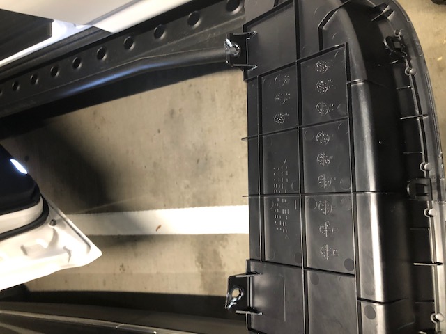

Thanks. Had a few minutes and ripped it out. Popped it right where the screw points were. Haven't popped it back to see if mounts flush and check for rattle etc but so far it does what I needed it for (running wires to the jack storage area). I guess a little double tape or some sort of adhesive might help in case it rattles..
