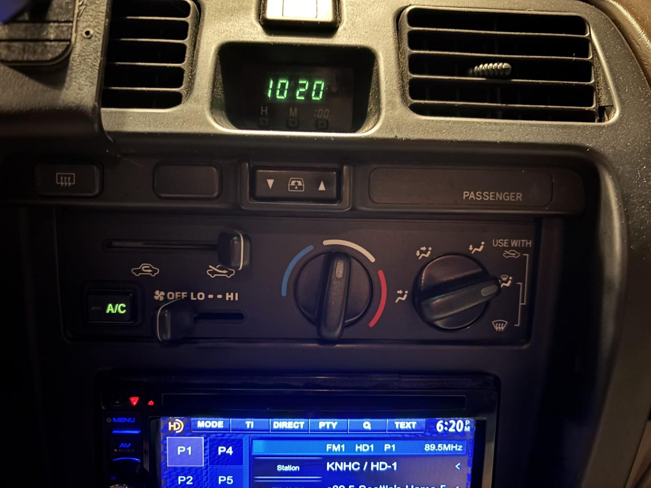

How to replace climate control lights?
Any idea how to replace climate control lights and the rear window button light?
You have to remove the radio bezel to do both.
Once you get it off you can pull the AC panel out. The bulbs are really easy to find once you get the panel and knobs/switches off. There's three there.
The rear window button/defrost is a little harder. Once you get the radio bezel off you can pop off that section that holds the switches and get to them with a screwdriver and replace them.
Thank you! Are these the right bulbs to get? https://www.amazon.com/LXAUTOPCH-Co...mate+control+bulbs+20004runner,aps,237&sr=8-3
