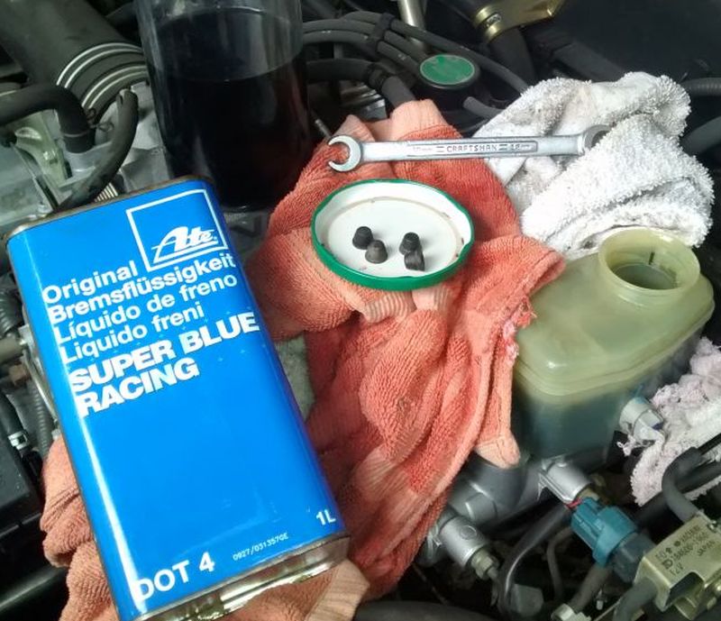

No, I didn't have to. Checked the level before starting and watched it carefully. Picture attached upon completion. It was exactly where I started.

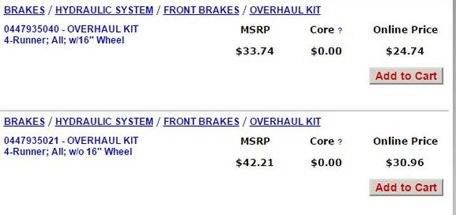

The dealer does sell a kit to rebuild calipers.
Thanks for confirming a rebuild kit exists.
I had looked on Camelback under BRAKES - BRAKE COMPONENTS - FRONT but then I looked again and found it under BRAKES - HYDRAULIC SYSTEM - FRONT BRAKES - OVERHAUL KIT.

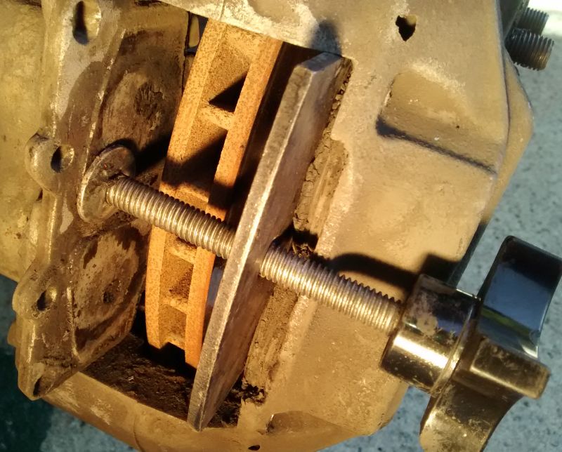

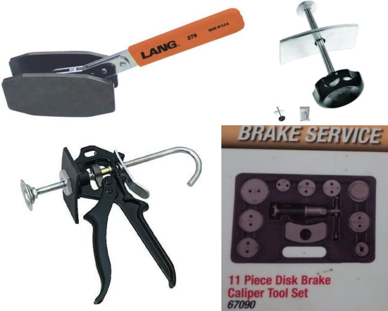

Thanks for that suggestion as I looked at that spreader which O'Reillys sells, where the package mentions that it is supposed to be used with the calipers off the vehicle.
When I was at O'Reillys, I noticed that they rent for free the kit shown below which I ask others if it works well for spreading the pistons evenly without removing the calipers from the vehicle?

The link that [MENTION=69868]LittleCaesar[/MENTION] posted is a great tool for doing exactly what you're looking for.
That tool may be the cats meow, but I'm not sure yet, because the package of that tool, at least the one I looked at on the shelf at O'Reilly's, says it's for use only when the calipers are off the vehicle.
The problem with my piston spreader tool was that the pushplate still needs to be larger (deeper, wider) to push the entire piston in perfectly evenly. You can see in the photo below that the threaded rod hits the caliper too soon, which limits how deeply the spreader plate can go inside the caliper.
If you work the pistons a little at a time you shouldn't have any problem with torn boots.

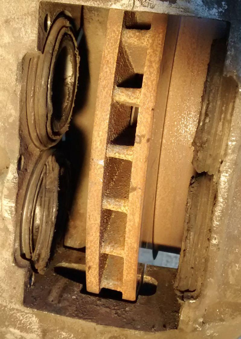

Since I like to learn more about everything I do, I was experimenting with all sorts of brake spreader tools, because it was a learning process, but in that process I learned it might have been better not to experiment, as I tore the boots.

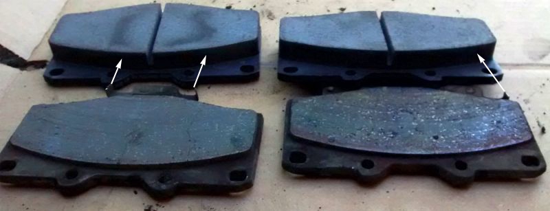

Original pads with 133,000 miles on them is pretty damn impressive.

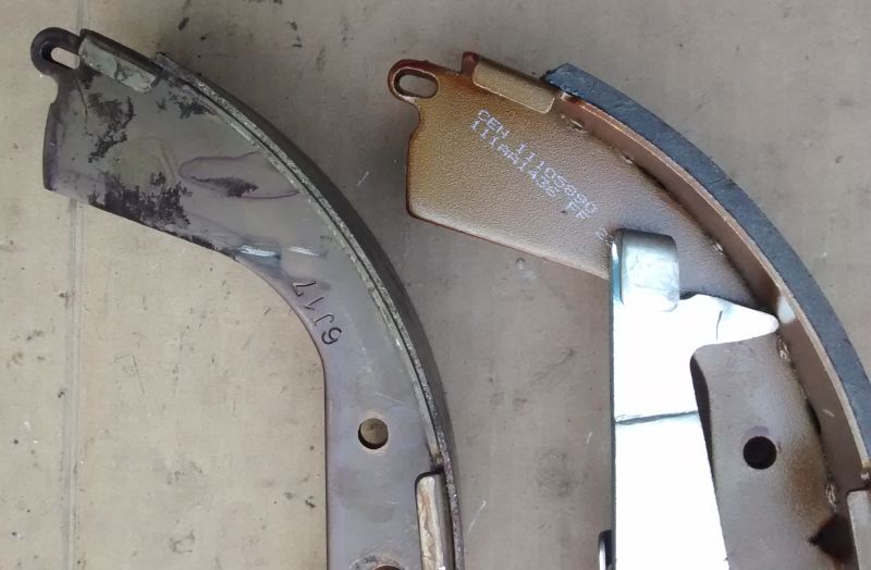

I agree that's impressive. The stock rears generally last forever (180K to 220K miles, and even then, it's only the bottom half of the front shoe), but my fronts are usually shorter lived.
Here's what the rears looked like at about 180K miles, old and new after following the Timmy the Toolman detailed video.

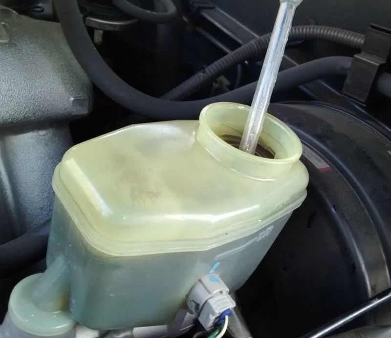

I guess I could ask also [MENTION=116467]Rock_Rat[/MENTION] if you drained any fluid in the MC before pushing the pistons back in? I always have to.
I had first flushed out the old amber DOT 3 fluid with 20 ounces of new blue ATE DOT 4 SuperBlue hydraulic fluid.
So to be on the safe side, I used a syringe to lower the level from Max down to Min, which was probably more than I had needed to do.

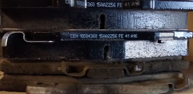

Without going into too much confusing detail, from my conversations with Toyota customer support, the OE fronts are Akebono EE (e.g., "AK PA533 EE A17"), while the OE rear shoes are Nisshinbo FF (e.g., "NBK LN508 FF").
I replaced mine with Centric FE and FF pads and shoes cold and hot friction coefficients respectively.
