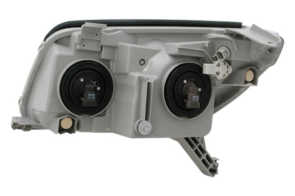

Here's a pic I found online. The small gray holder in the upper right pointing down at a slight angle is the parking light socket. When the wire harness is plugged into the back of this, it creates the slot. You're essentially placing the screwdriver head in next to the plug.

The housings are a bit different for the 06-09 than the 03-05, It looks like it's a bit easier to get to the newer style one (which is the style they show in the vid). The 03-05 headlight is like the one i posted above where the parking light is up towards the top and rearmost of the housing which makes it a little more tight for access.
