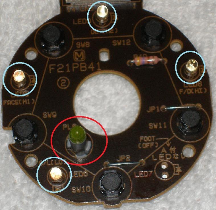

Hey all, thaks for this thread, it has been a lot of help! So far, I have replaced the bulbs, and have gotten the clock display to show. However, I am still noticing that the labels on the dials (ie: Lo, Hi, all of the various fan positions) still arent illuminated. The orange triangles at the end of the various selections light up, but the labeling itself doesnt.
Does anyone know which bulb specifically controls these? Or is it possible that it is a fuse issue?

Hey there. I've included a pic here to help. The bulb circled in RED is for the lettering on the panel switches. The lights (actually, they are LEDs) circled in BLUE are the arrow illumination. These very rarely, if ever go bad. Some of us have changed the LEDs out for different colors, and added an LED to the "OFF" position, but that's covered in another thread.

Thread revival !!! Im assuming all the LEDs circled in blue must be changed by soldering....and even then there is still hotspots since the LEDs don't project light all around?

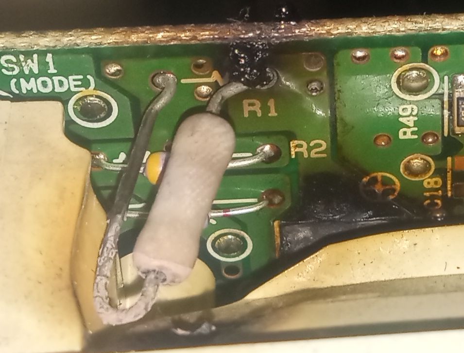

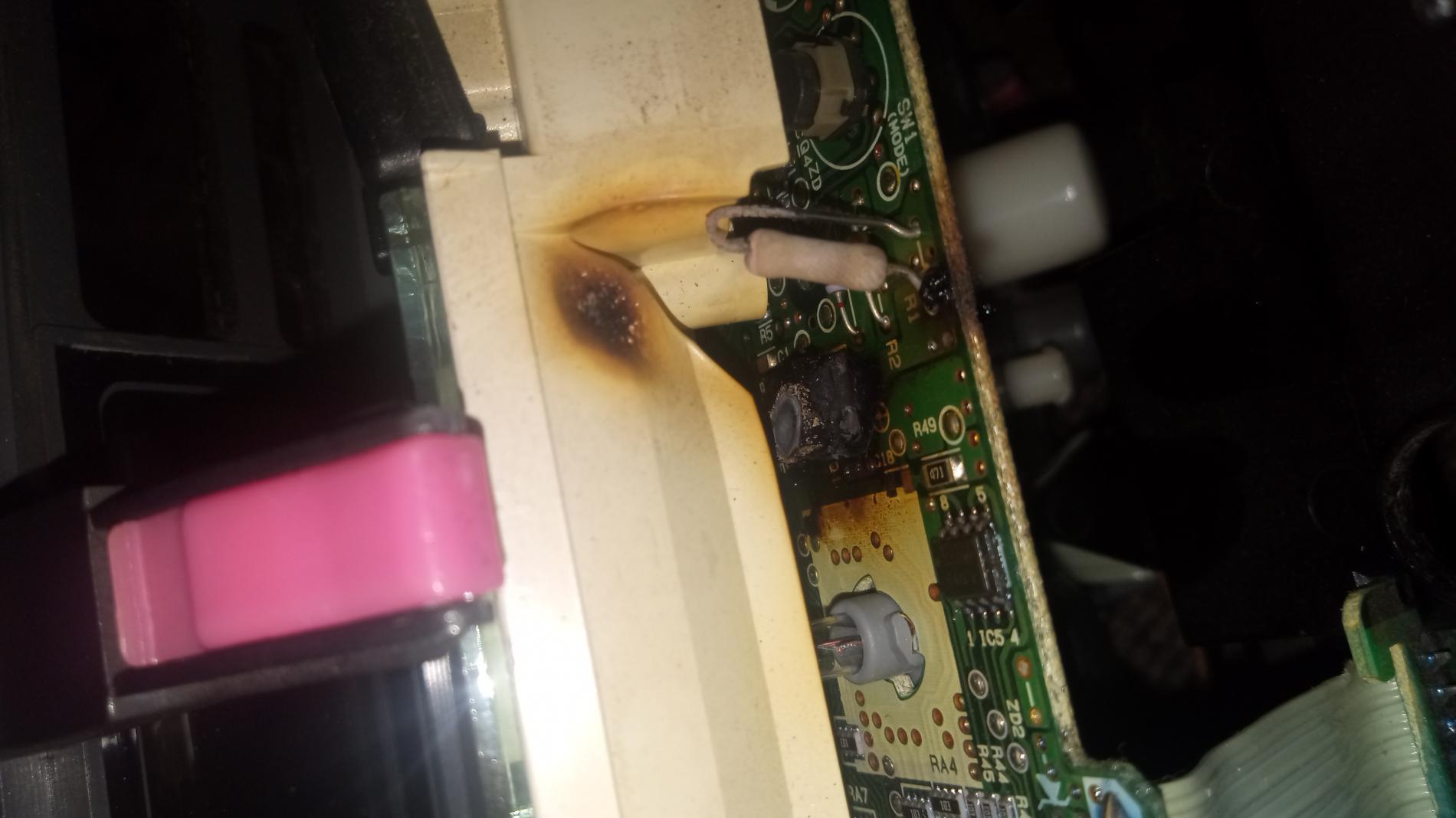

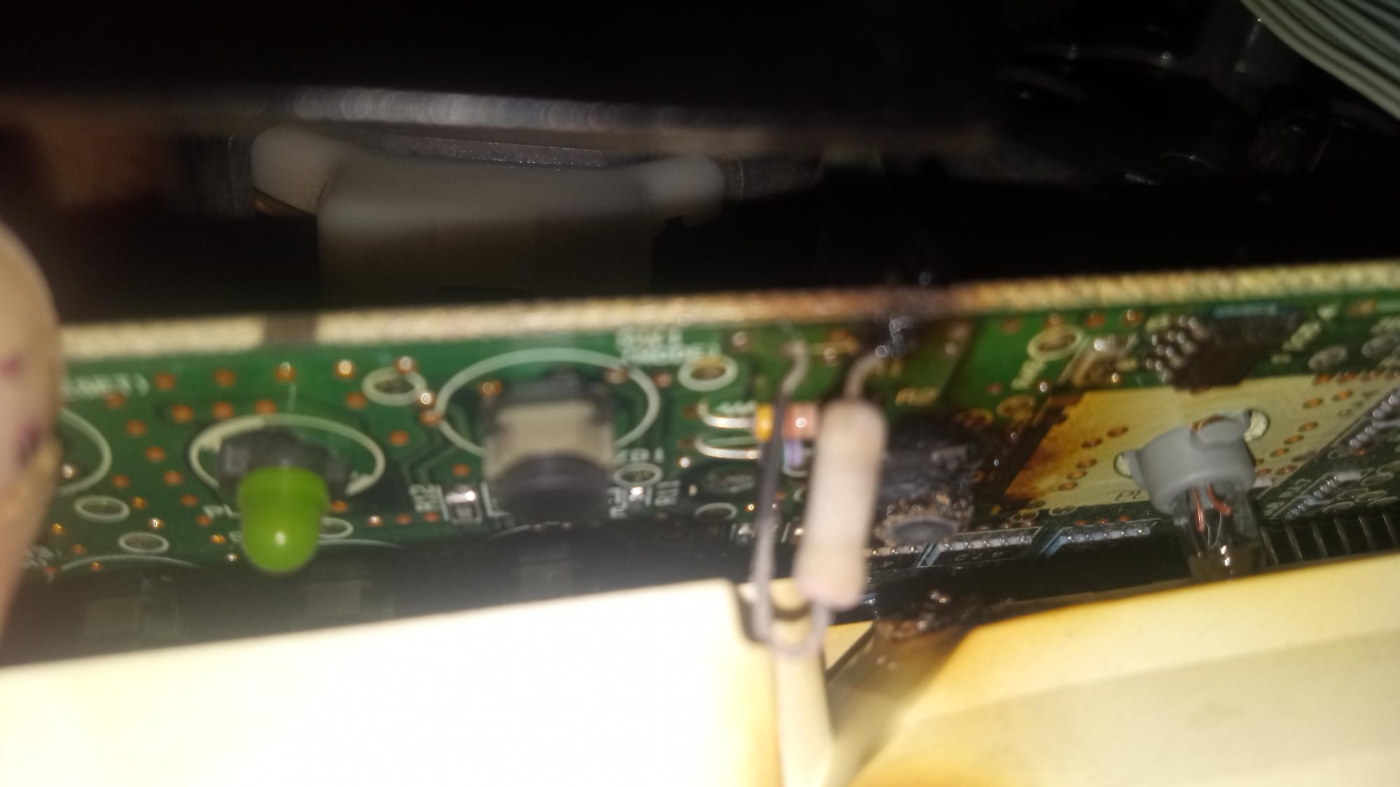

I had the wrong bulb behind mine and it melted the plastic and other stuff I'm trying to figure out from taking these pics what I need to do. I have the correct bulbs but now the whole display doesn't light up

OK, first I think you're confusing "bulbs" with "LEDs".
They both illuminate but are totally different things.
In your top pic the green 'thing' on the right is an LED and the clear 'thing' on the right with a light blue base appears to be a normal incandescent 'bulb'.
The tan thing in the middle by the dark brown overheated/burned area is a resistor (although the resistor itself doesn't look burned/overheated).
Not sure which you changed but my guess would be something you changed caused an overcurrent condition which overheated the resistor and damaged one or more surrounding components.
If you changed the (green) LED you may have installed it backwards (it's polarity (+/-) sensitive) or the bulb (not polarity sensitive) was the wrong one and drew too much current.
Either way this is just a guess based on the little info to go on.
Good luck.

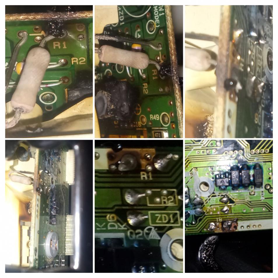

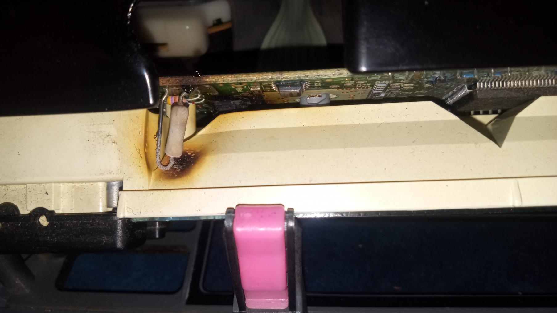

I'm not confusing LEDs and bulbs I didn't do anything to the green bulb it's the actual bulbs for the back light of the clock in the range display that I changed out and with those stupid little bulbs that you can get online like the ones from radio shack and it overheated and started smoking while I was driving and I had to unplug it while I was driving and this is the damage it did and I know that's a resistor I just don't know what the resistor look like before it swell up and turn colors. Also every time I plug it back in it does the same thing so I don't know what to do but I need to be able to control my air conditioner
More pics of the damage. I wud really like someone supposed to picture of their circuit board so I can see what that resistor looks like before mine swell up so I can order another one thank you

From looking at your photos, I would think you need to replace the entire circuit board with one from a salvage yard, I could be wrong.
If you do get photos of what it should look like I think you need to post the year and specifics of your T4R, i.e. is it a Limited, SR5, etc, since there are differences in the controls and hince that circuit board!

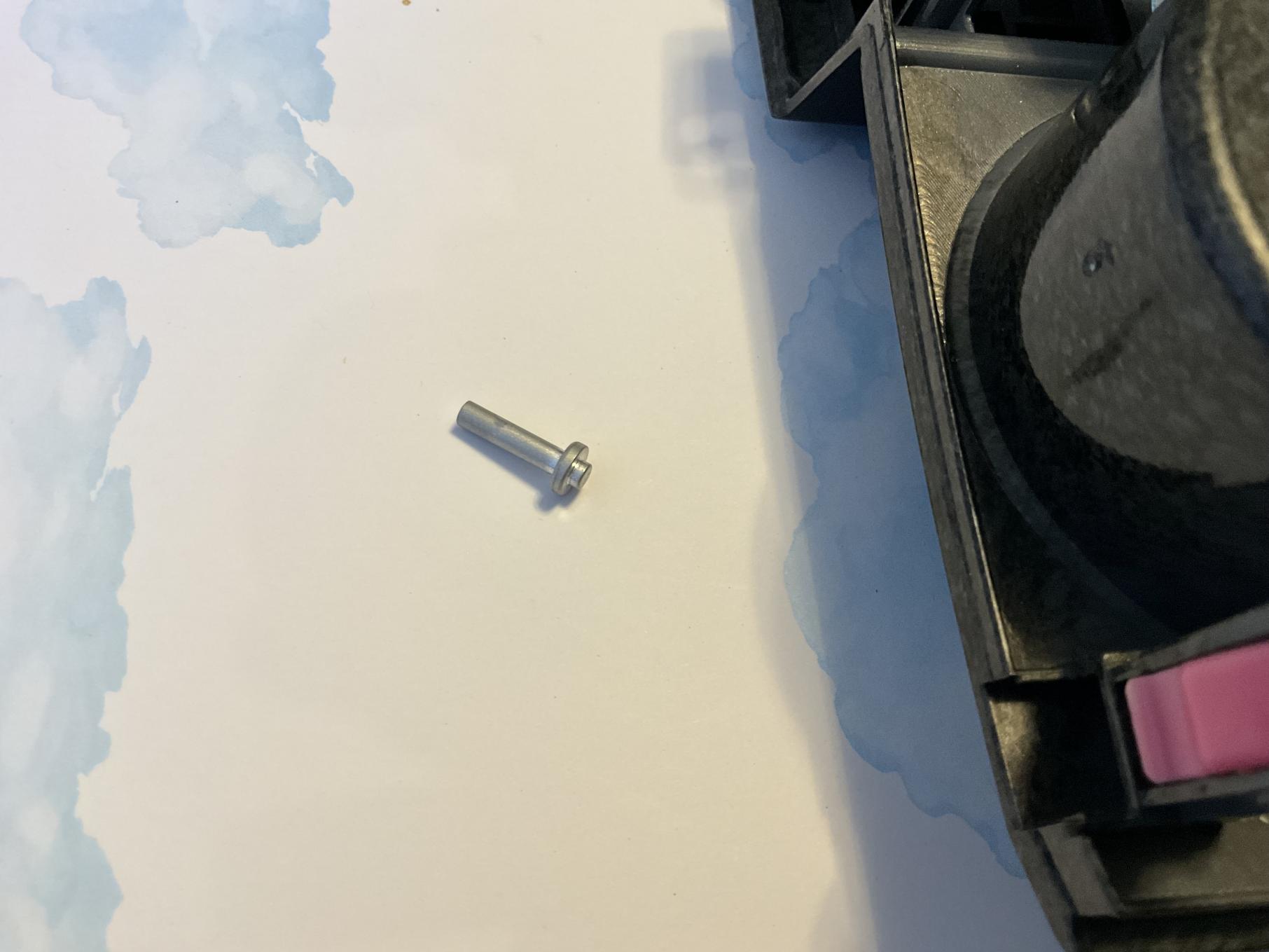

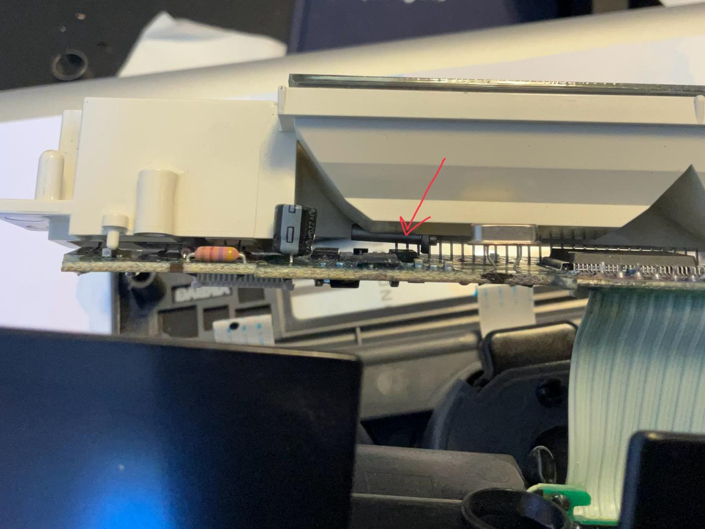

Help! Great post. I was looking for pics on this topic. I need some additional help. I started out planning to change one bulb and it has become a headache for me and much bigger job. The little plastic cover on old bulb came off when trying to remove bulb. Then it fell down into opening completely. I started removing some screws, then more screws then down to the board in attempt to shake the piece out. It came out along with this silver piece which I have no idea where it goes. Does anyone know what this part is and goes? I saw another piece inside but i think it got loose too in my shake. So there are 2 pieces I need to reposition. HELP!
