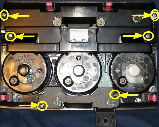

I know this may not be a hot topic, however, it does come up from time to time. I took some pics and mostly just circled the screws to come out in yellow w/ yellow arrows pointing to them as well...
Here you see 6 screws need to come out. 4 in the top panel, and two in the lower panel.

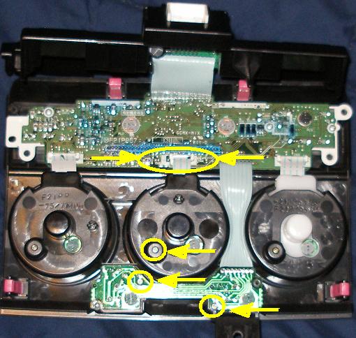

Next, to remove the circuit boards from the plastic housing completely, remove the 2 now exposed screws on the bottom circuit board. The top half will already be loose.
The ribbon cables will have to be released as well. Simply (*carefully*) lift up on the white plastic tabs on both sides of the ribbon cable. You will feel it pop loose. Pull the ribbon cable out of the socket on the circuit board.

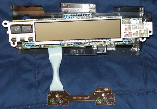

This is what you will have once removed from the housing. If need be, you can take it apart further by removing the small screws, but I didn't go that far.

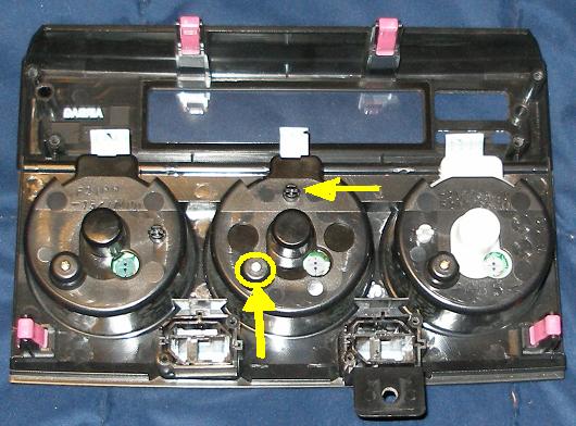

To remove the big switch assemblies, disconnect the ribbon cable as described earlier, remove one screw each, and it will be held in place by a small plastic piece. It will just push through now and seperate from the housing as well.
