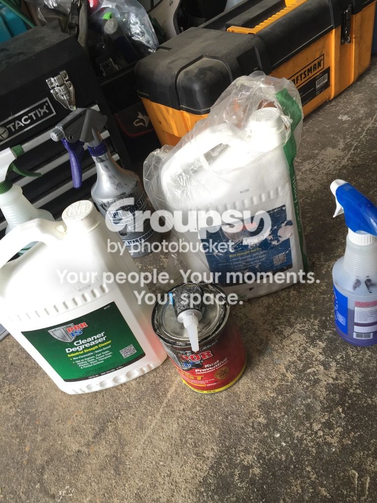

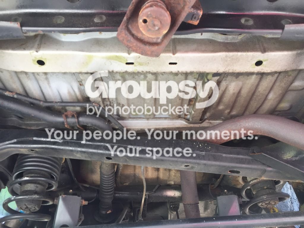

How's this for rust protection. I degreased the rocker panels under. And por15 !!!
Like I said. Didn't really have rust. But with POR15 metal prep you can coat smooth metal. So I wanted extra protection from water, mud and salt.
I used por15 marine cleaner and por15 metal prep ( shit burns !!!)

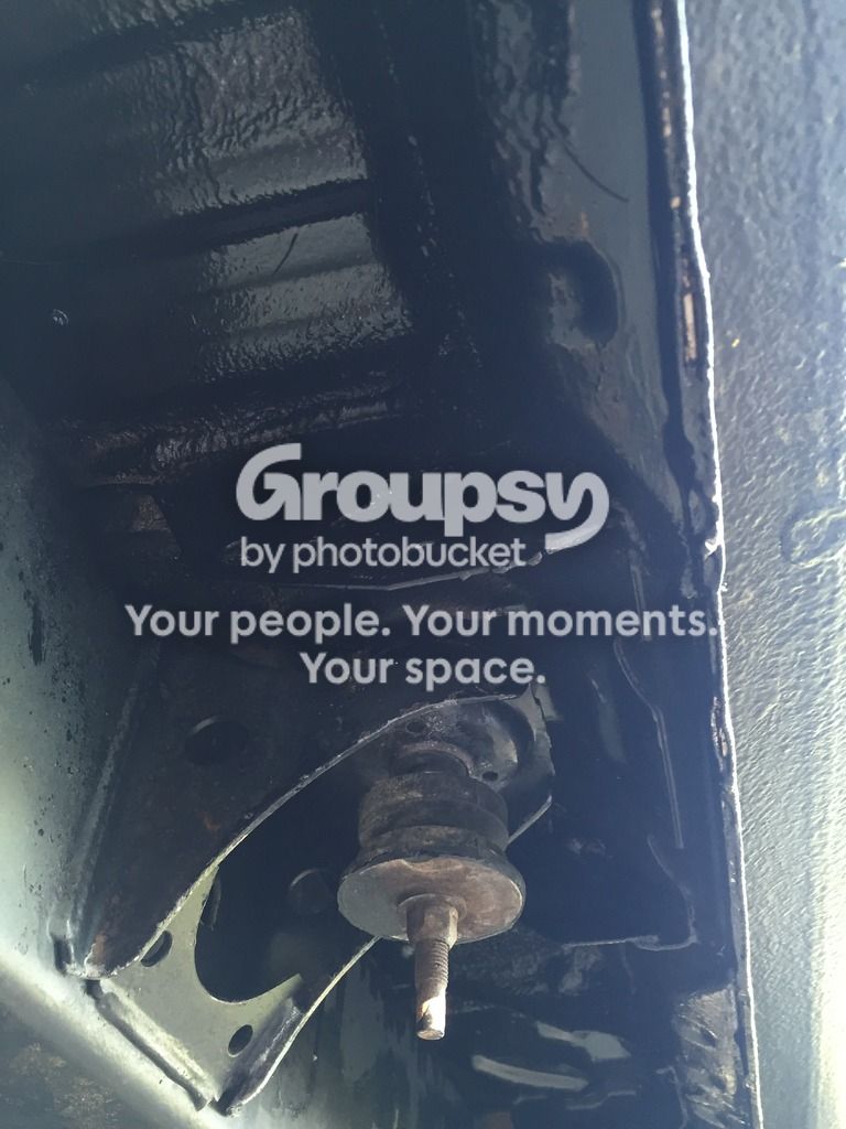

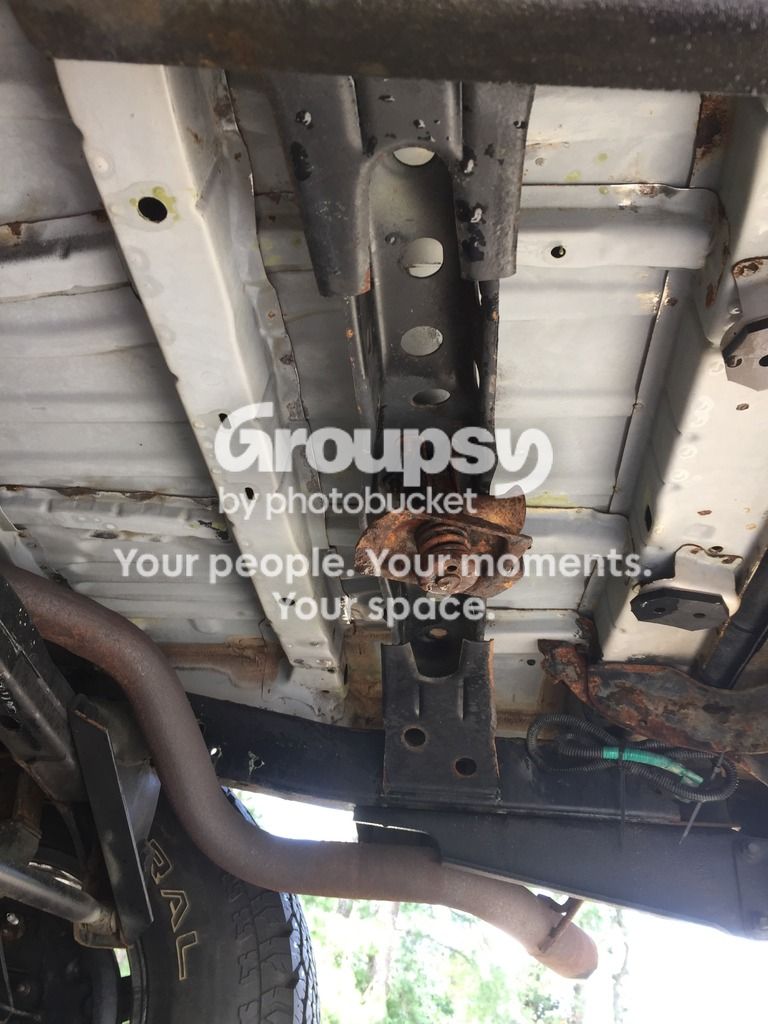

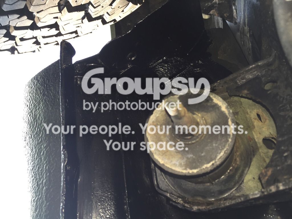

This is before degreasing it. It was covered with fluid film.

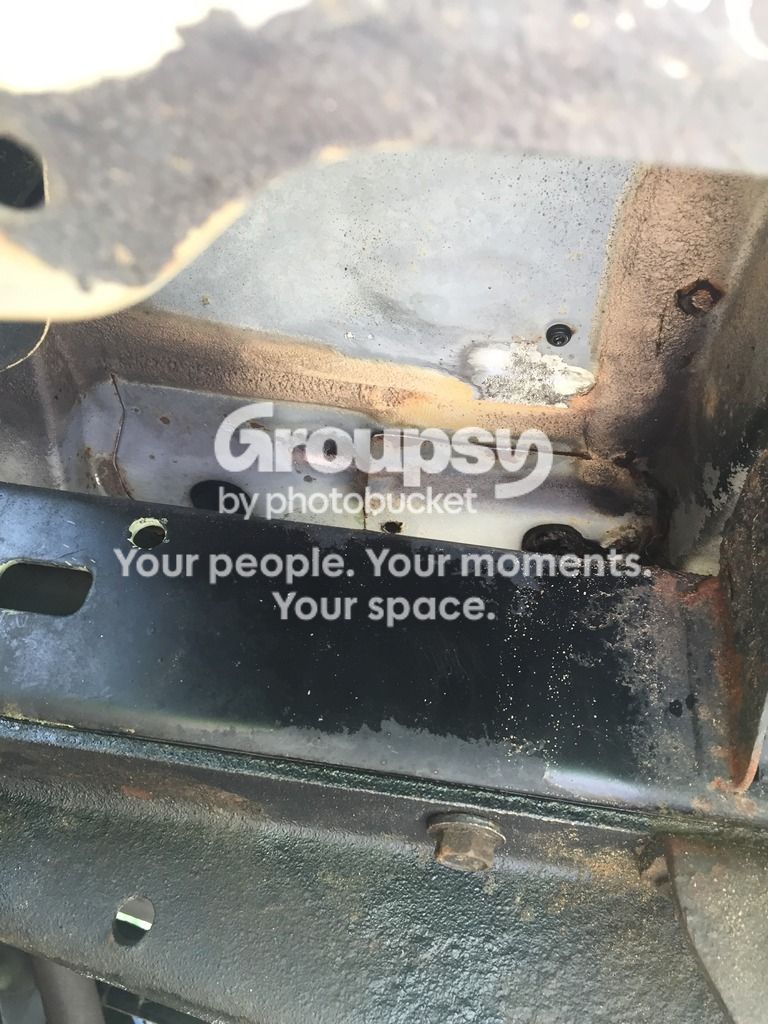

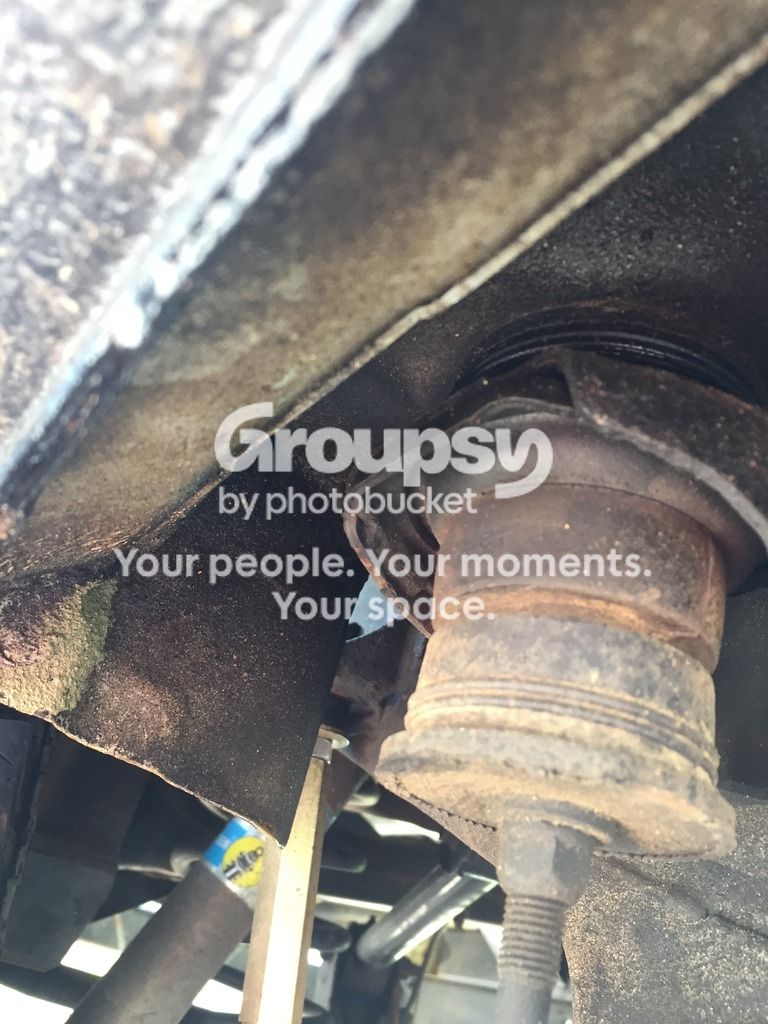

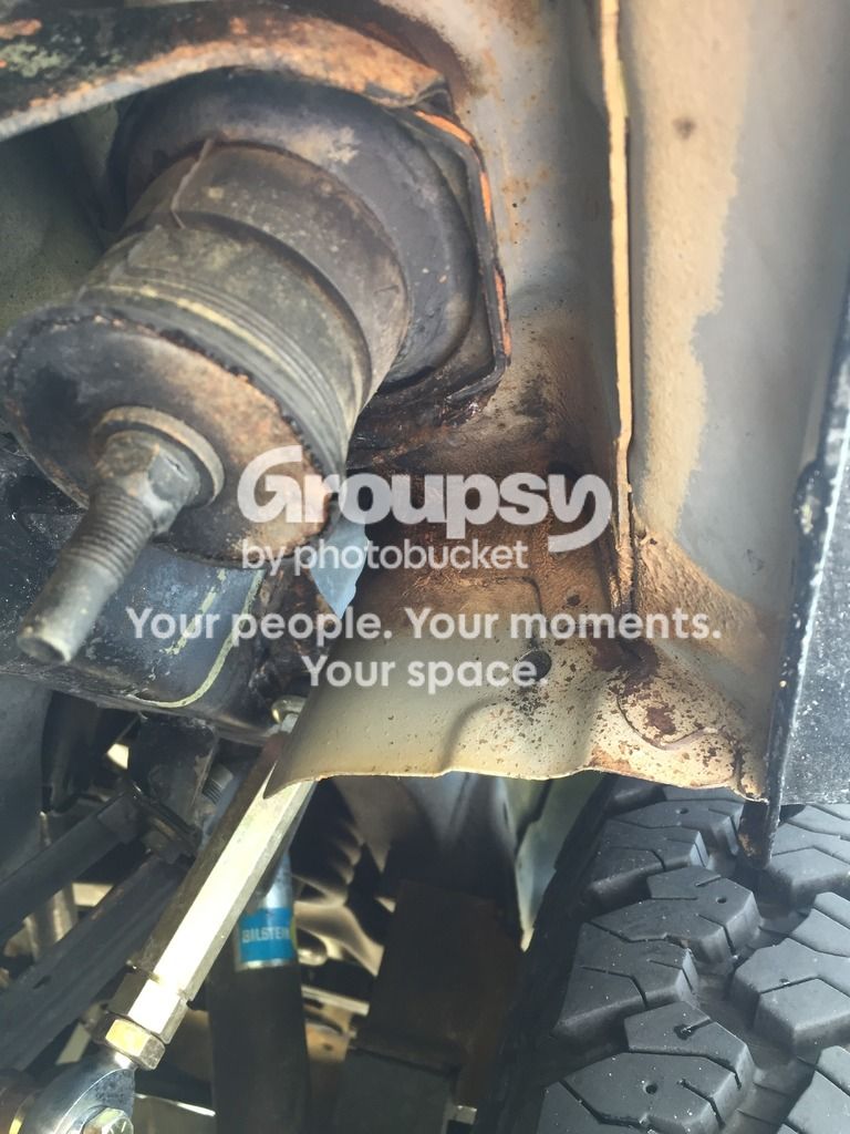

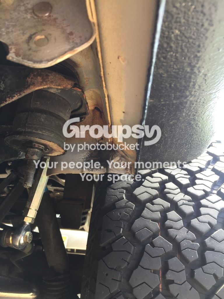

This is the back of the wheel. There was minor rust developing. In all my truck being from NJ is very clean. But as everything, it rusts. And believe me. I have done everything to fix it and prevent it. Except that I didn't do this before. Before I focused mostly on frame. Anyways....

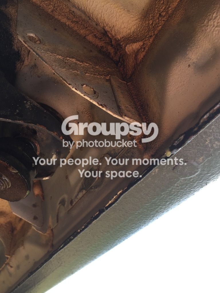

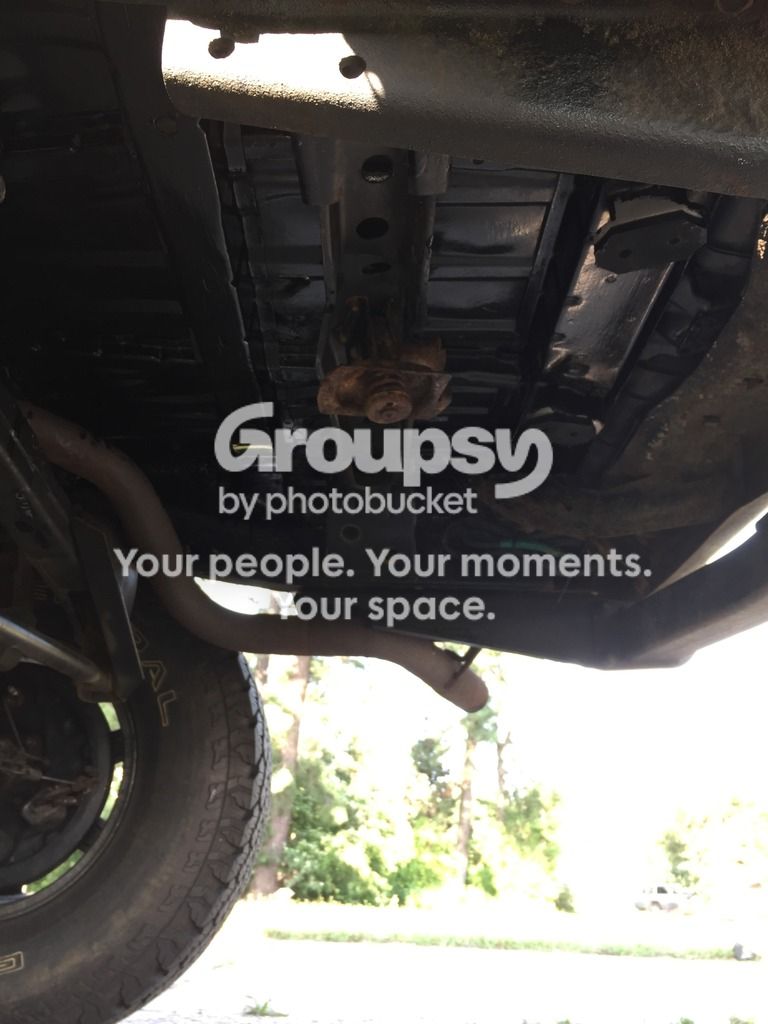

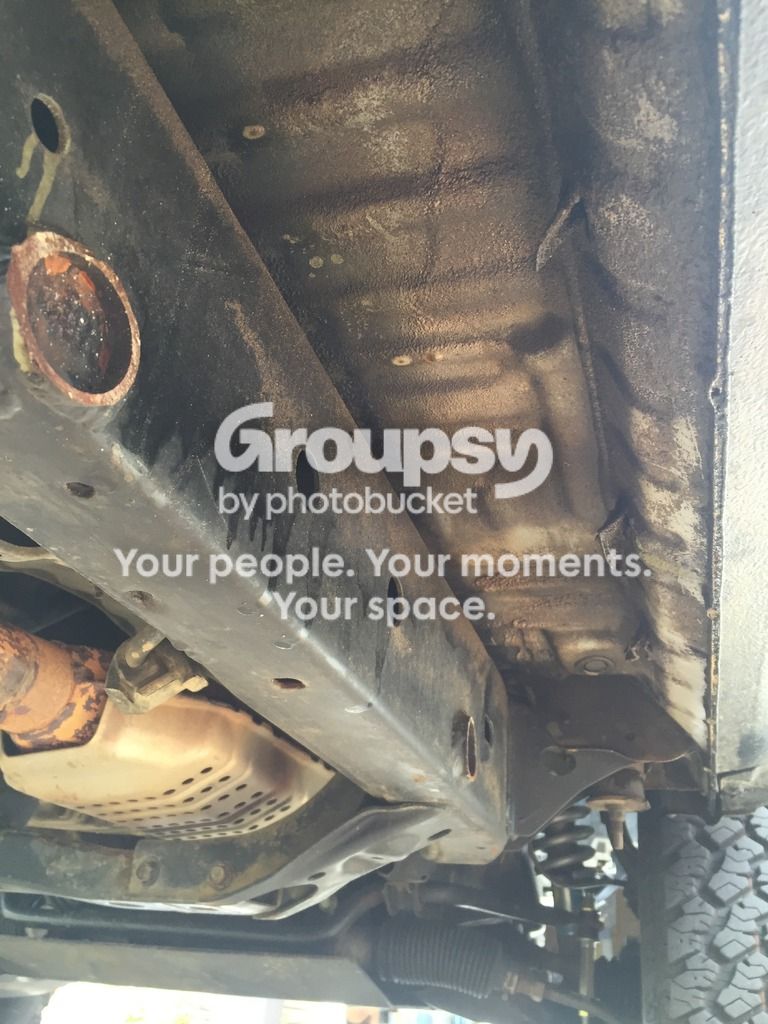

After degreasing it. And washing it with water. Those are the steps according to por15.
You can see some sanded areas. Sorry I know it's hard to see.

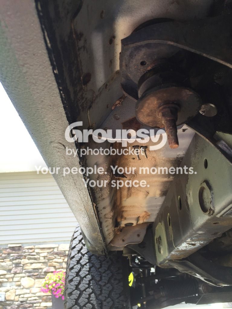

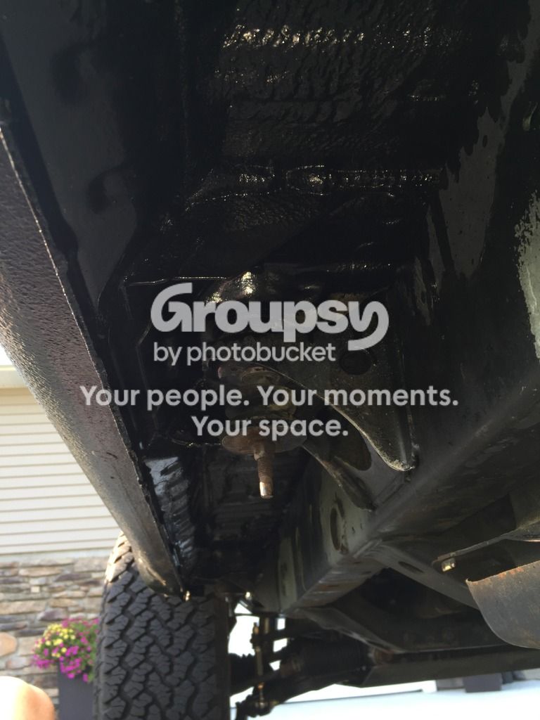

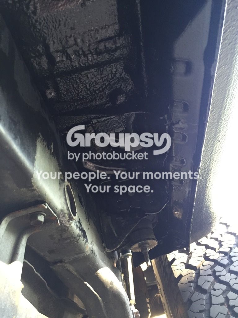

And POR15. Along the whole side. Both sides driver and passenger and rear.
