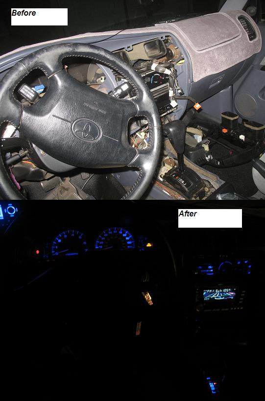

Hey you all,
I did this mod on my 99 T4R and it was not that difficult. Though, the toughest part was getting the right light bulbs ordered.
Going through these treads, it was not easy finding the right info for the 99 T4R as far as the light bulbs needed. So I originally ordered 7 #74 light bulbs and 2 #194 light bulbs. It turns out, i actually need 9 #74 and only 1 #194. The #194 going under the shifter. Here is a finish product, though I still need two light bulbs (#74), one for glove box and one for ashtrey.
