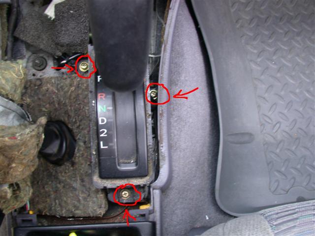

Unscrew 2 screws for your shift cover. The blue circles indicate the screws in the picture. Put the 2 screws in the small area where your e-brake is at.

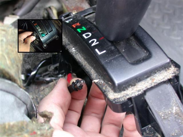

Reach under that cover piece and twist the light out. You will noticed there is a green condom over the bulb. For me, i just took the green condom put and didn't replace the bulb. Didn't felt like wasting any more money so i kept it clear bulb which will show up amber.

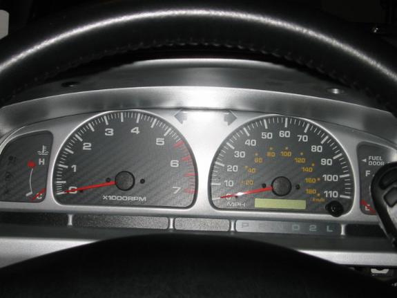

And now for the finale. Here is the picture of the overall mods.
The amber light of the shift knob.
The climate control light. I didn't bother to change the A/C button because it's only 1 LED without wires and plus, i couldn't wire up a resistor to it so no point.
The complete gauge without the aftermarket gauge lit. You will notice how much the needles are brighter than before.
The overall gauge with the aftermarket gauge lit. Can you say WOW? =)

with 4WD there are 3 screws here (not the issue, just for anyone with 4WD doing this):

Either its my year and newer or the fact that its 4WD but theres no condom/colored sleeve over the bulb and my bulb is a lot smaller:

you can wire an LED in replace of that LED. sorry about that. i didn't know different years of T4R would be different. good luck.
