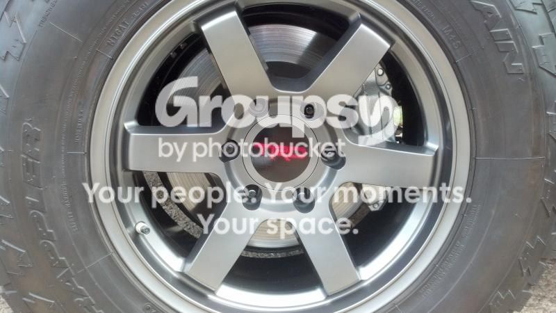

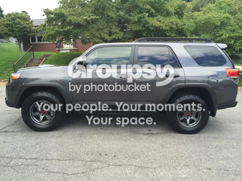

I've got these wheels on my 2012. The wheel does indeed fit the hub like a glove. It can be a little bit of a pain in the ass to get it back on by yourself. LOL! That being said, I left the center caps completely off and just primed and painted the rear hub centers flat black.
Here's the fix.
[MENTION=57349]93toy[/MENTION] Sweet. Those wheels look great on your rig. Where did you get the Decals? Are those vinyl and are the holding up well? I also have a MGM 4R but mine is the ltd. I keep going back and forth on the gunmetal and matte black and I think I just decided on the gunmetal finish. trying to figure out which ones to go with. 17x8 or 17x9...
