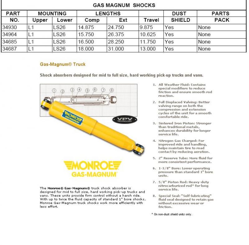

What do you mean by what size shock? The bolt hole at the top or how long they are? I dont remember off the top of my head, I can get measurements next time Im down there. Ford part number E5TZ-18183-A, can also get them from low range. And the 11.75" shocks (34685). I need to brace the front ones, or they will crack..
I forgot about the tower measurements. Ill get those tonight
