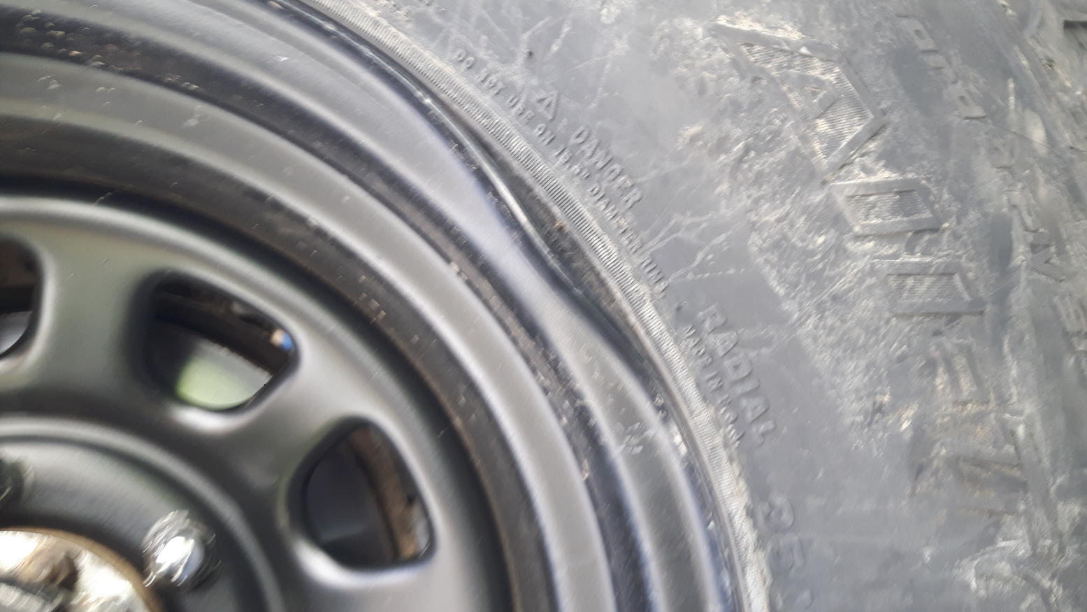

Hey bent my rims while 4x4ing on weekend. Best way to fix.
Pics

If its not leaking air... leave it alone... just re-balance the tire and call it a day.
If its out of round to the point its leaking air or causing vibration even after re-balance... attempt to fix, or replace.
+1
But if it bothers you cosmetically, Google rim repair shops in your neighborhood. I have a few that are local around me. One of them is pretty reputable, mostly repairs rims for dealerships but will take on repairs for anyone.

Sorry I know this is ancient but the responses you got were dumb.
It's a steel wheel get a hammer and tap it straight again
Or get a 2x4 place it on the bend and hammer it straight
Or
Dismount the tire and get a crescent wrench and pinch just the lip of the wheel and pull outward till straight.
Really not that bad of a ding, but from the looks of it, the wheel is a pro-comp style and they are pretty cheep to replace $60 range if you can't get it hammered out.
I agree with the above. Depending on severity, if you can afford to replace I would do so. Can save you in the long run.
