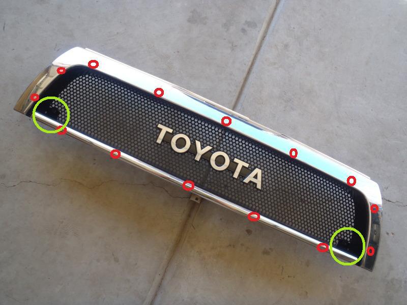

Ok BigFish, this is pretty insignificant from what you've been doing lately and it has actually been quite a while ago, but I have a question about the satoshi mod. I'm guessing the perforated aluminum you used isn't very thick, so do the mounting bases and zip ties cause bending in the middle of the aluminum plate? Also, what stops the lateral and longitudinal movement of the plate against the plastic part of the grill? I see the zip ties are very tight, but after time won't the aluminum plate creep downwards?
The aluminum is little more than 1/16" thick, so it's got some backbone to it. That being said, it does not bend under the tension of the zip ties. Re the lateral movement, it is prevented by the way that I shape the grille material around the frame. In the attached image below of the grille I did on my '97, note the areas circled in green... at each of those corners I carefully shape the grille material to precisely fit between the two mounting points on the lower corners. In addition, the grille material is folded around the frame at each side, further preventing movement. It is VERY secure. If you tried to move it side to side, you'd break the frame of the grille before you got it to move.
