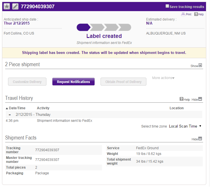

How'd you get that shipping info on those sexy Valentines undies I sent you!?
It was supposed to be a surprise!
oh well..... Enjoy them.
