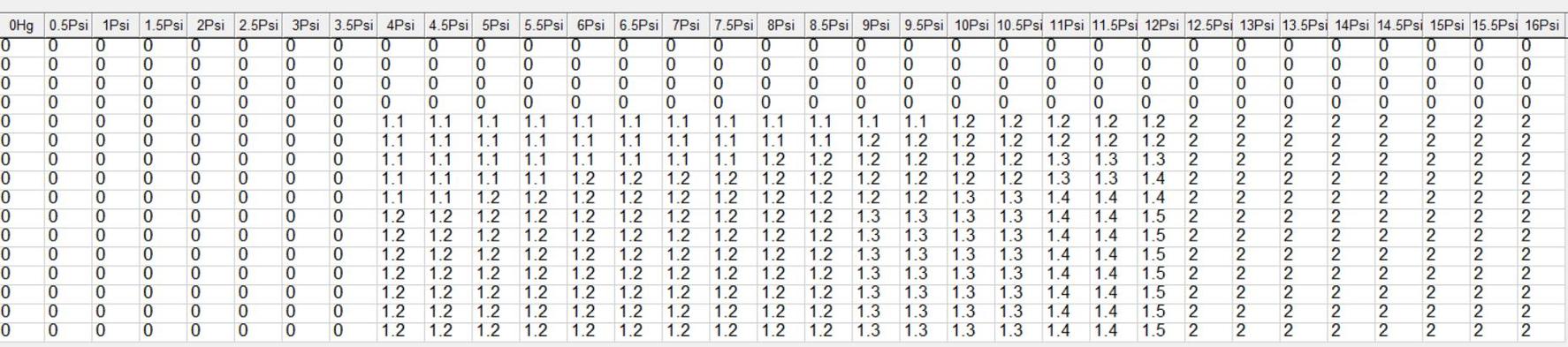

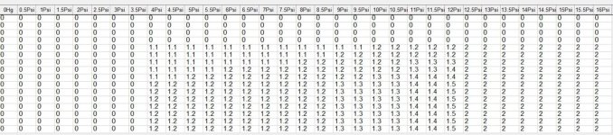

Lately I've noticed that my wideband is showing some funky AFRs at idle and they seem to be running a little lean, hunting up and down between 14.7 and 15.3, usually above 15.0:1. I suspected my front O2 sensor might be getting a little lazy, so I replaced it as PM, but the readings are still the same, so it looks like my wideband needs a calibration and/or a new sensor.

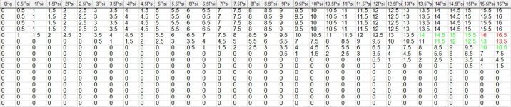

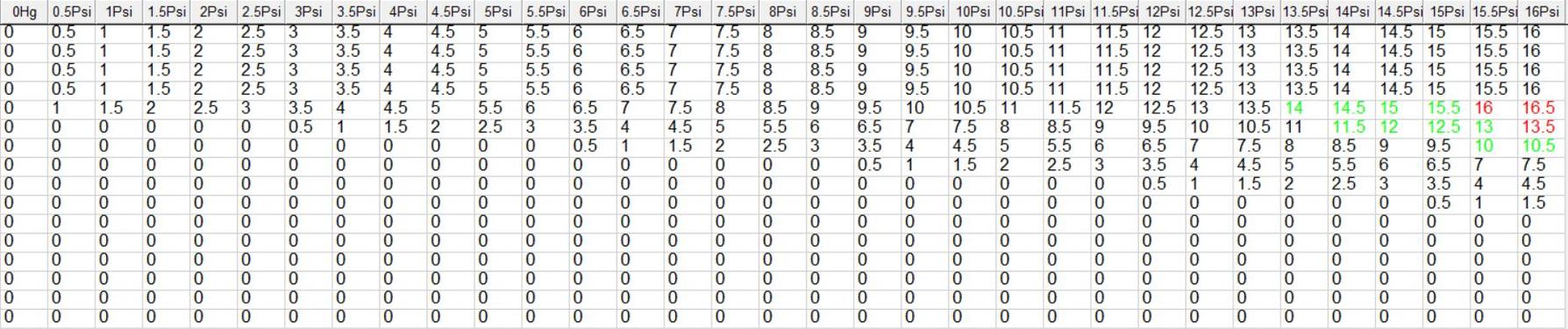

Last but not least, I've been tuning the 7th injector for the new intake and figured I'd post my most current maps. These maps are producing WOT Open Loop AFRs of 11.6-11.8, and Closed Loop AFRs of 13.6 under boost. My LTFTs are still a little high, and low boost open loop AFRs are still a bit lean, but otherwise all is well. These maps are producing zero ping on a 2.2 pulley.
Curious about your tuning maps! Where you're at it's about 5300 ft elevation, I'm around 4300 in Reno, NV. My fuel maps are pretty much 1.1 - 1.2 all the way up to 8 psi and my WOT hits around 11.2 ish with the 2.2 pulley and 7th. You shouldn't need that much fuel at your elevation right?
Also, I'm wondering why you have your timing numbers all the way out to 8k rpms, I've found out that anything above 3k rpm is hard to make ping, so if you put little to no timing above 3k you'll get way more power up there. Just an observation, my tune is far from perfect, I may give yours a try and see how it works.
Every engine is different. Two otherwise stock engines running the S/C and 7th might require different tunes. In this case, I am running a different intake setup than you, headers, a different exhaust, gearing, etc. There are many differences between your rig and mine, thus a much different tune. The wideband doesn't lie.
As far as the timing, the amount you pull out will get added back in by the ECU up to the point that the knock sensors report a problem. Pulling timing with the 7th ECU at higher RPMs won't hurt power because the factory ECU will just respond with more advance. The only way it would become an issue is if you pulled enough timing that the stock ECU hit max advance and still room to advance timing.
